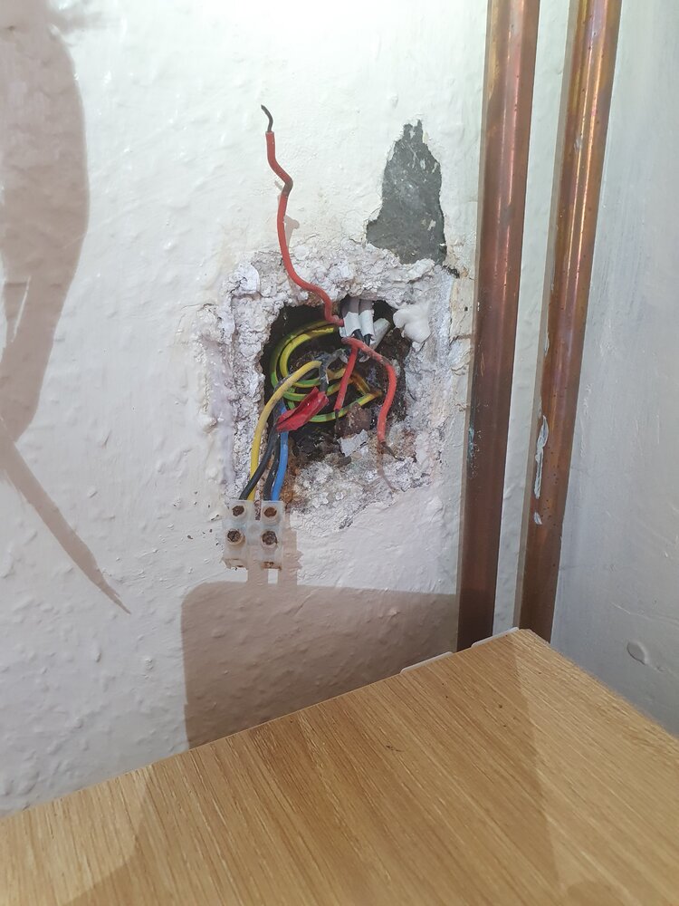

Had a nightmare of a day trying to get a small 2 bed 1900 or so terrace house through its EICR today for the landlord.
He's one I work for, so its a case of fix as I go to get a satisfactory rather than just report.
2-3 hours was sorting out the downstairs lighting circuit failing on IR L-E with 0.44MOhms (all loads removed)
Not much left of the in wall back boxes but even with everything pulled out, the main problem turned out to be a short switch extension in 3 core and earth from one room to another. (perm live to switch, 2 switched lives back)

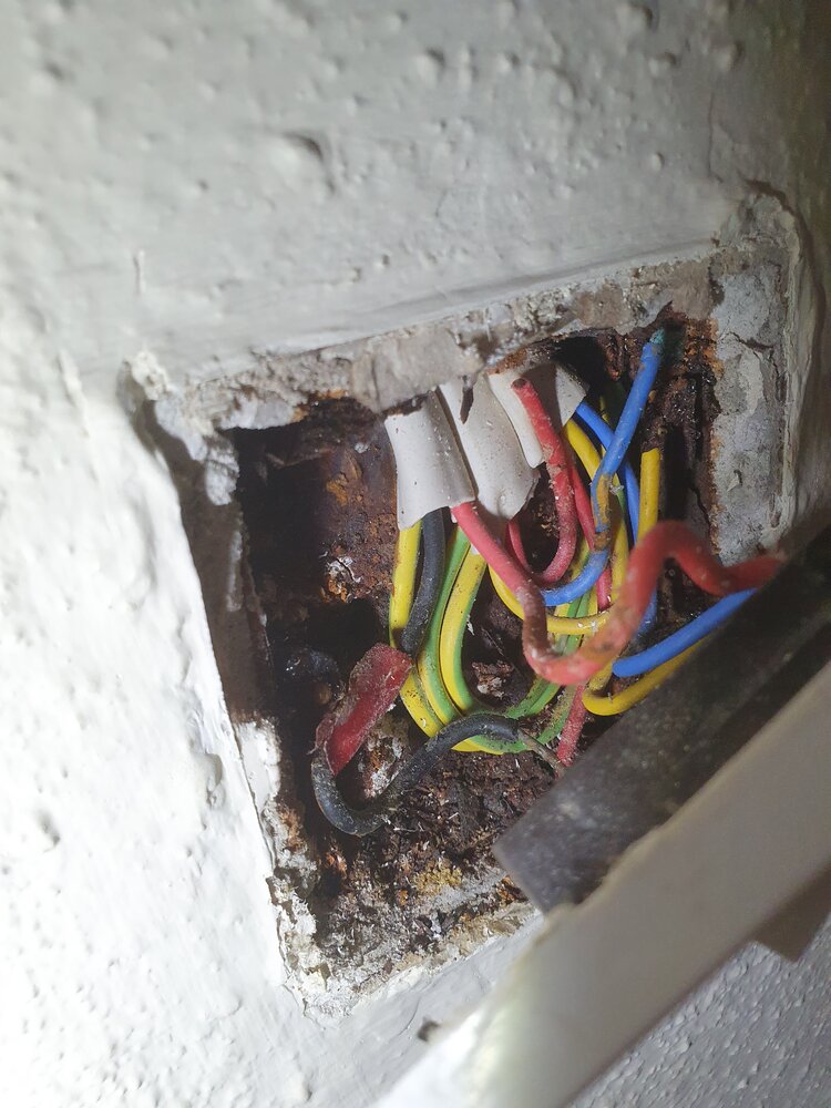

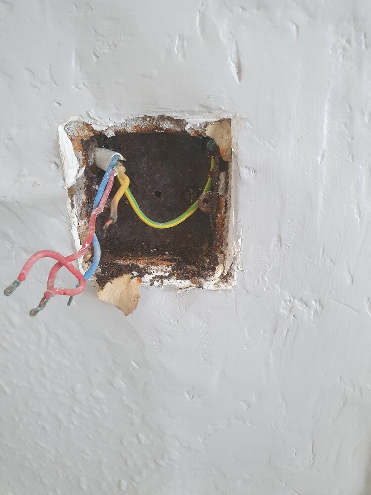

Nice pictures of what remains of the back boxes....
Only one of the cores was failing (perm live), so with some rejigging of switch locations I managed to get things to pass for now at 2.4MOhm on 500V (though bizarrely was getting 0.7 on 250V). Had to put surface pattresses for now though to get the switches back functioning.
It's fairly clear that the switch drop cables have been affected by the damp - the ends of all cores were that dull black, and cpc was bright green in places.
Some remedial work has been done for the damp, so this may be historic damage, but given the age of the house it might also be impossible to completely solve.
The wiring at light level seems fine, it's only the switch drops that have been affected from what I can see - unfortunately I think they are in junction boxes somewhere in the ceiling, not at the pendants so rewiring will likely be fiddly and disruptive - though it will likely have to be done at some point.

Hi,are you sure it is e degradation of the insulation,and not a localised or single,localised bit of damage,providing a path for your IR readings. The difference in readings on 250/500v may possibly be due to that path being cleared by a higher voltage,at a small,localised part,whereas a general failure of insulation,over a run,,would give a more consistent reading,over consecutive tests.
If it is one core in particular,which is giving a low reading,it points to a more definitive reason,rather than a overall clue,of the complete cables failure,due to damp.
I know it's probably more poking around,than it deserves,but by separating and disconnecting the cores,checking continuity/resistance,to confirm equal standing,you can IR individual cores,with reference to both earth and each other,with various alternative combinations,and build up an idea of what may be occuring.

I had exactly the same problem with a ring final circuit. The IR was 0.3 Mohm. The offending cable (after tracking it down) was buried in a wall which was absolutely sodden and the back box (galv) like yours was rusted away (so much for galvanised!) My answer was to chase out the cable completely and replace the cables via a hole in the ceiling I cut, and put them surface. IR was then 459 Mohm. We had to core drill through the same wall it took about four hours going through the wet wall, end terrace outside wall. It was soaked through and through. Interestingly, the more we removed of the offending cable the better the IR readings go. We chased a bit (meter) then tested, then another meter and so on when we got to the ceiling it was as above reading. So it is graded and gets worse the more cable that is in the wet wall.

More likely over the years the water has wicked up into the cable by capillary action.
Agreed that can happen but unless the insulation becomes porous or is damaged I would still expect a good IR.
But the inner insulation, not the outer. Which would explain why T&E outside in water is OK.
Sounds similar - the cable worst affected in this case had been run horizontally through the wall, though even then only one core to earth was giving me the failed readings so was able to reuse the other two for now.
I'm fairly sure I'll have to replace from ceiling down in conduit - It will be the landlords call whether I put it surface mounted or in the wall I guess - though based on drilling chasing won't be difficult, just messy.

I've certainly seen plenty of outside T&E to lights that's been exposed to weather for years and not damaged, but I guess you cable was probably terminated properly at both ends? I imagine this damage may have crept directly up the copper from the terminals, which were green and nasty...

It's quite possible, though nothing obvious and by the time I'd got things to an acceptable level I'd had enough of poking around...
Unfortunately it looks like I can't get at both ends of the cable easily as they aren't junctioned at the pendant (might be above the ceiling there if I'm lucky) so not easy to separate legs.
I'm hopeful that if I track down the switch drop at ceiling height and test there things will be fine, then I can rejoint and run in conduit/trunking...
