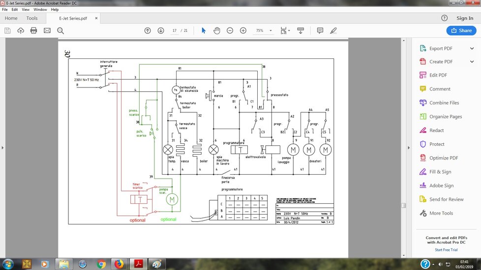

Commercial dishwasher stopped working. Water heats up but when the temperature reaches the right temperature the wash start button doesn't start the wash cycle. Checked everything out. Buttons, motors they all fine. Drain pump works but the behaviour is whacky. Normally you press the drain button and release it when you hear the drain pump kick in. The button powers a relay, the pump starts pumping, water drains, water pressure switch breaks circuit when the tank is empty and pump stops. Instead you press the drain button and the pump starts. You release the button and drain pump stops. You have to hold the drain button down to continue draining. Now here's the odd thing. As the tank drains with your thumb on the drain button it gets to a point, before the tank is empty, where the wash cycle begins and it does so even when the door is open ie: the door microswitch is being bypassed. I have a had a good look around for signs of short circuit but can't see anything. Opened up the loom. There's usually a bit of a clue if wiring looms are leaking. There is a relay contactor in the machine that sits between the timer and the various pumps. I am thinking the problem might be this contactor. What do you guys think?

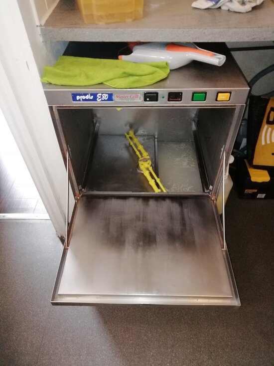

Still, if it's any use to anyone it is a Prodis E80. I attach a picture of the washer.
The contactor is a Prodis T50 30525 30 amp. So if anyone know these to go bad let me know.

It is being bypassed. It has a five cam timer. The cams are not free to move independently. I have checked that thoroughly. Literally watched it go round through the wash cycle. The filling, heating and wash cycle is fine. Plus the contactor as described. There's no electronic control board. The wiring diagrams are very crude and not much use to be honest. Also in Spanish. It's a 2 minute wash cycle. It's this odd behaviour of the draining process that's the issue. The drain doesn't use the timer. I say that because the timer doesn't move when draining. The only shared component between the wash and drain cycles is the contactor. That's why I think it's the problem.
Hi - I'm not experienced with this machine - but here's a few Sunday morning thoughts :) .
The circuit diagram green section has the drain push button (scario) and there is a feed back connection after the button is pressed and the contactor closes (at 38). This keeps the drain pump (pompa scar.) on till the circuit is interrupted by the pressure release switch (pressostato at top right of diagram near 3, 8, 81), as you've described used to happen. So that "latching" circuit is not working and that could be the contactor or a connection to it.
The door switch (finecorsa porta 4, 41) is on the bottom of the drawing and if the door is open the main pumps in the DW should be off...

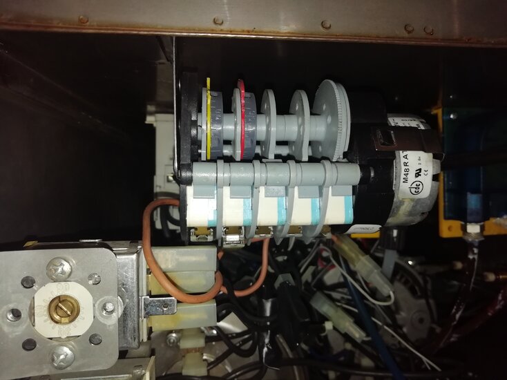

The yellow disc on that controller looks a bit dodgy.
It looks a bit gnarly but that's the rinse aid pump cam and that's working fine. Looks like it has jammed up at some point in its life and would probably be a good idea to replace it. But it costs £180 so if it's working that'll do for another day. The contactor s £110. I think that's my priority at the moment.

I would be tempted to mark up the cam switch terminals,and leave the motor connected,whilst the switching is checked,to iron out any seized or non-functioning contacts.

Check the terminal numbers and configuration,of the controller,and just check the N/O and N/C operation.
In the past,i have rigged a simple pair of lamps (larger watts the better) and popped a 3A fuse in the test supply (C) just to watch what and when the lamps perform.
You would do this,on each of the 5 cam switches,but the short cycle,makes this easy enough. I would urge,not to remove the drive motor,and manually operate the cams,to speed the job up. I have had previously faulty contacts,decide to function,when whipped through their cycle,at an increased speed.:)

Test the contactor. That's the plan. The drain process, which is wher the problem lies, doesn't use the timer so I will focus on the drain process. I will be looking for a way I can energise the wash cycle relay via the drain relay. I just wish the wiring diagrams weren't so primitive. When I get it out there may be evidence of damage. I had an endoscope in there and there is some brown marking on the contactor casing. Maybe it has gotten wet and shorted out. We shall see.
