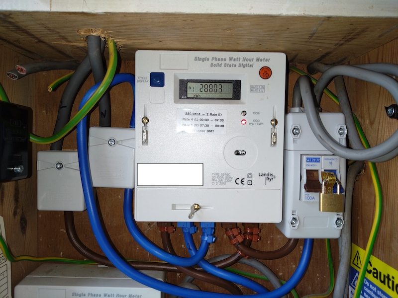

I'm gonna give them 3/10 for effort. They did re-connect the client's power, but... well. See for yourself.

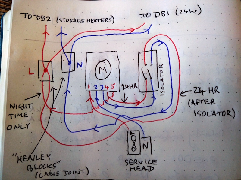

It's a very cramped meter cabinet in the service area of a block of flats. As well as the client's meter, there's also a meter for the flat amenities DB next to it. Client is on old-style Economy 7: meter has 2 line outputs, one for the 24 hour DB serving lights + sockets (DB1), the second line output serving DB2 which has old-school storage heaters: no timers, just local 20A DP switches on 16A radials, they rely on only having power when it's cheap. DB2 is a PVC consumer unit with RCD main switch - it's fine. DB1 is an old Wylex fuse box - will be replaced by an RCBO DB.
There's no space to install a 4-pole isolator, but we only need a 2-pole isolator, for DB1. This is what they installed:
Here's the schematic:
I'll post what's wrong (and why) when I get back from Tesco's... if anyone (including trainees) wants to have a look and work out (a) what's wrong, and (b) why it's either potentially dangerous, or means that things won't work as intended, then comment away! I'll post later what the outcome was.

Always worth remembering that meter fitters are untrained and have almost zero electrical knowledge. They go by what their job sheet and tick box exercise says, connecting a cable could cause a blind panic and lead to 6 months off with stress for them.
In retrospect, your synopsis was bang on the money
Oh my word. I feel a strange mixture of incredulity at the basic conceptual errors and and rage that people are allowed paid to do work like this under the umbrella's of large organisations without adequate training.
And a mix of feelings that it is so dangerous that a complaint is warranted, along with resignation that nothing would happen.
Bit ropey having both live supplies commoned through that connector, with only 24hr supply isolated.
Less than ideal if storage heaters/ off peak water heating rely on off peak supply for timing.
Return visit from meter fitter or timer for off peak board?
My particular favourite is this scenario:
  • isolator off
  • off-peak goes live
  • loads are connected to off-peak DB (DB2)
  • neutral (on DB2 and DB1) is disconnected from source N by isolator so...
  • Neutrals, on DB1 and DB2, including N bus bars, go to 230V
  • L to N (on both DBs) tests as 0V (although L-E and N-E will read 230V)
  • DB2 looks dead, but isn't
  • DB1 looks dead, and the intention of turning it off at the isolator is that is should be dead, but isn't
  • The RCD(s) won't save you either, as they're further downstream (on outgoing circuits)

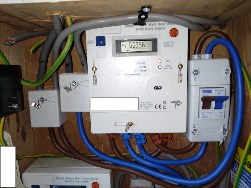

Here's the outcome:
... and schematic.
Yes, I did put blanks in the L Henley block.
Just need to get EDF back to check the tightness of the outgoing N on the meter (did not break the seal) - tried hard not to twist/disturb the outgoing cable, but may have done. Flat unoccupied so no load on it at the moment.
