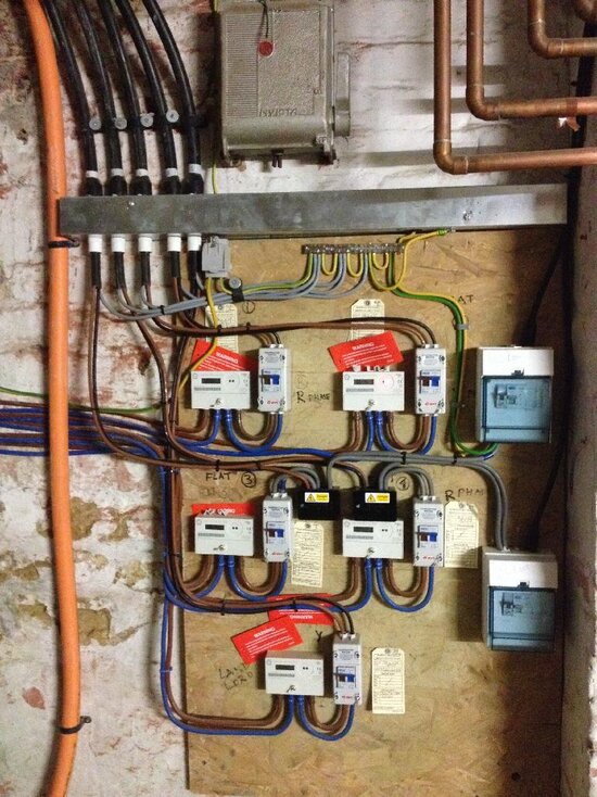

hi ya'll
got a query, just questioning my judgemet
been o look at a job were a spark has done a disappearing act and work needs finishing the scenario-
total rewire, new3 phase mains incoming and gas etc
5 storey building
x4 new flats all new installs
by the entrance ground floor x4 submains each has 100a switch fuse cutouts for each flat and a landlords c/u. all fed via 25mm 3 core SWA from DNO 100a cutout in the basement.
my thinking is they should have switch fuses in the basement as its 20+ metres from DNO cutout to the switch fuses?
also the landlords supply has no switch fuse at all, just straight from DNO isolator.
the 2 mini boards are for pump for 2 of the flats

So there unsheathed cables from the output of the isolators?
Looks shocking.
Get yourself some trunking and grommet strip
Reactions: 1 person
Agree mate but didn't want to sound rude but you did it for me
One mor observation what about sleeveing on the cpc
this is how I have found it, the swa sheath wasn't even earthed, which I have done.
not sure how to get around the unsheathed cores
I don't think its the fellas work if I'm right, but yea was thinking that, bit of sleeving.
Anyway those tails from the armoured will get snagged too.
I can't look at that pic any longer.
the tails from aroumered run through a bush, so go through metal trunking without harm but, I really don't know why he has done like this
im carrying out an EICR as agreed, as they need building regs approval asap, they did want me to sign off as mine!! hhhmm don't think so
Reactions: 1 person
They should be in an enclosure.
Thats right or M/C switch fuses bushed directly into the metal trunking eliminating the need for non sheathed armored cable cores
I would love to see whats hiding to the left of the picture
it does need switch fuses at this location doesn't really?
as from here its 20+ metres to the ground floor switch fuse isolators he has installed
Alright I'll be a brave boy bloody awful rip it out and start again, complete crap

I don't know where to start , there is so much wrong with it. As Pete says rip it out, start again and do it right. Trying to put right what is already there will take longer than re-doing the job.
Regards.
Trunking already in situ, M/C Switch fuses bushed into said trunking underneath, SWA terminated into said trunking, unsheathed SWA core run into individual Switch fuses with appropriate earth sleeveing . Insulated and sheathed tails run to DNOs equipment, all nice and neat and safe oodles of space left

I think you've already stated your doing one but before I'd even consider touching this stuff it would be a day or two of indepth inspection/test (EICR) to baseline the whole installation --- if you think it looks bad at this end I be scared sh*tless would might have happened at the flat ends!. Then and only then can you discuss the way fwd with whoever owns the place and how you are going to rectify & certify it?!?!

I'm just baffled how a provider would install the meters with the install looking like that.
Must of been a big brown envelope
yes I have commenced an EICR today and going through the 4flats ad found some issues that I have been asked to address as I go. only seen the basement today as couldn't access it on my initial visit, hence my concerns and sound advice needed
it has surprised me too that the DNO have put the meters so far away from supply and the main cable in crosses over the meter tails
I'd be cautious just in case the previous guy bailed because of non payment.
Maybe just do the EICR and issue an invoice.
See how it goes from there.
I have been paid for today on the job, and I have done a different job for the contractor ordering the work and paid for that also, so im not worried on that front, in any case they wont get any paperwork until im fully paid
