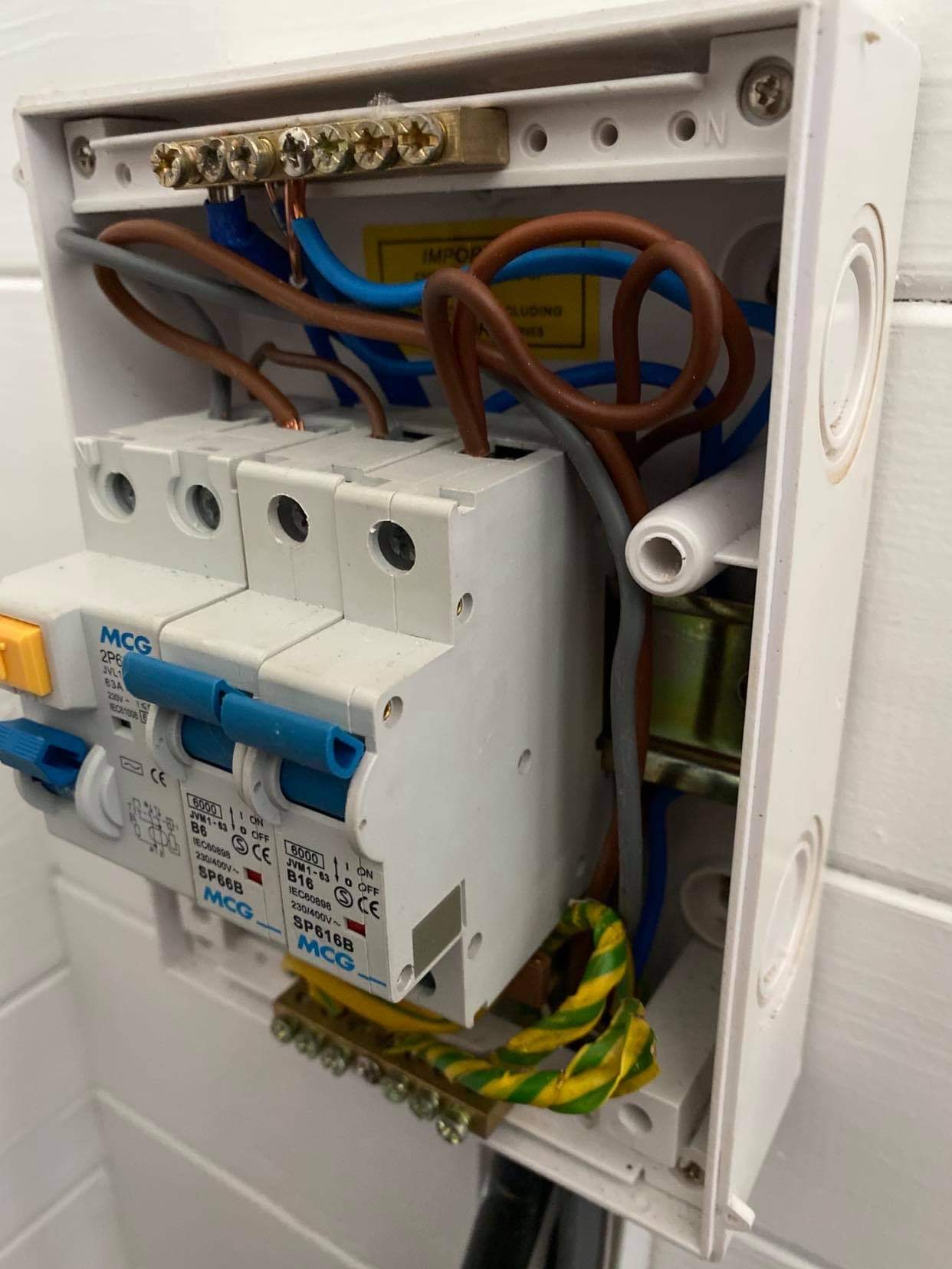

Don’t have a sketch for whole garden yet but here is one I had for the summerhouse.

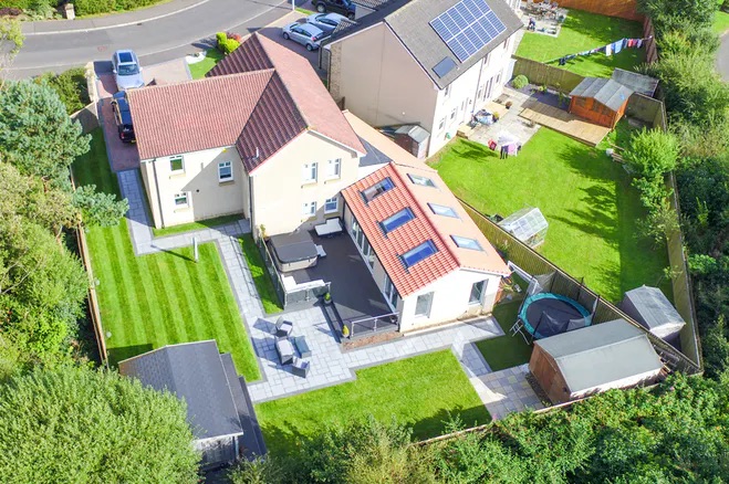

I’d probably be looking at 4/5 lights either side of the summerhouse which is positioned in the corner of the garden. So I’d have them up each fence. I’m just going to go for basic up & down lights such as these type…
UK-TECH Premium Quality Waterproof Stainless Steel Up and Down Lights Outdoor GU10 IP44 Double Indoor- Outside Wall Lights with Tempered Glass Cover https://www.amazon.co.uk/dp/B07PSD9GJN/ref=cm_sw_r_cp_api_glt_i_N0MPGY40N3EH9BN3RVAA
Or something similar but basically so they can shine up to trees and then down on to fence. I’ll put smart bulbs in them like I have on front of summerhouse so they can be controlled with app.
I have attached two old pictures of garden from the house sale advert. It shows the garden and location of summerhouse. I’d like to branch off up each fence.

It would be advisable to have the fence lights off a switch, just for isolation purposes.
When I first read this…. I thought… fairy lights, pinned to a fence… that would be enough…
Then I saw I size of your garden!
My god, man. Someone’s doing alright for themselves!😆
If it’s LED smart lamps, it’s not going to be a huge load.
Switch fuse next to one of the sockets… through wall to an adaptable box and run from there.
Just be aware of attaching electrics to a wooden fence. They have a habit of falling down in high winds..
And just curiosity… can you give a region of Scotland on your profile. There’s a few Scots on here that could maybe advise in person if you’re nearby
You need to get the wiring addressed at that consumer unit. The swa cables are not glanded and appear to have the armour taped and connected to the earth bar, there is no busbar shield, neutrals are hanging out of the neutral bar it looks a total lash-up.
Appreciate that mate!
Looking back at that picture I can see straight off what you mean regarding the neutrals hanging out! That definitley needs a tidy!
Don't know what has happened to the bus bar shield to be honest but that can easily be picked up and reapplied can't it?
How do you mean regarding the armour taped up may I ask?
I think he means here…
One taped up wire here will be the black core of the armoured 3 core cable… (the grey being used as neutral)
The other must be a few strands of the armour in the cable, taped up and connected to the earth bar.
As Westy said, it should have been glanded properly.
Could you explain or show a photograph of the other end of the armoured cable where it is supplied in the house?
I think he means here…View attachment 94802
