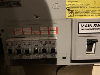

Hi telectrix, how can I confirm the CU is protected by an RCD? My house is fairly old.
no RCD apparent there. at the very least, a RCD fused spur is an option, but it's really time to bite the bullet and get that antique CU replaced with a nw unit upto current regs.
