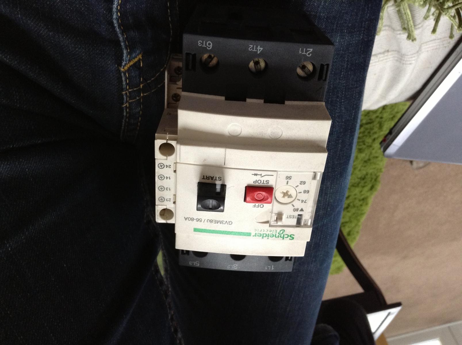

Sorry to sat Tel and rarely i correct you but this isn't a contactor its a thermal magnetic circuit breaker used for motor protection, it has no coil so is not a contactor as we would know, yes i know you know what it is its you just worded it poorly.
i stand corrected. never come across these before.

If the new one is ok and holds then yes old one faulty but its rare for them to fault so not worth worrying about, how old was the last unit and was it exposed to contaminants if under 5yrs old then contact Scheider they may replace it under the 1979 consumer rights act although over this 4-5yrs marker you may struggle.

Hi on the side you have an aux contact this will unclip. This maybe an under voltage trip which will make the button not stay in with power off what you nee to do is unclip the block and see if it stays on then if it does check you have continuity between the terminals 1L1-2T1 etc maybe just a faulty under voltage trip
