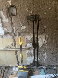

I have added a picture of current work

All I can see is 2 boxes chopped in and a bit of 2.5 in kopex ...Which is pretty normal at first fix stage
hard to judge the installation on such a small amount of work
Thats as much has been done up up to this point of install, so far so good then..

I don't know if its the angle of the photo, but those two newly installed boxes look on the wonk?

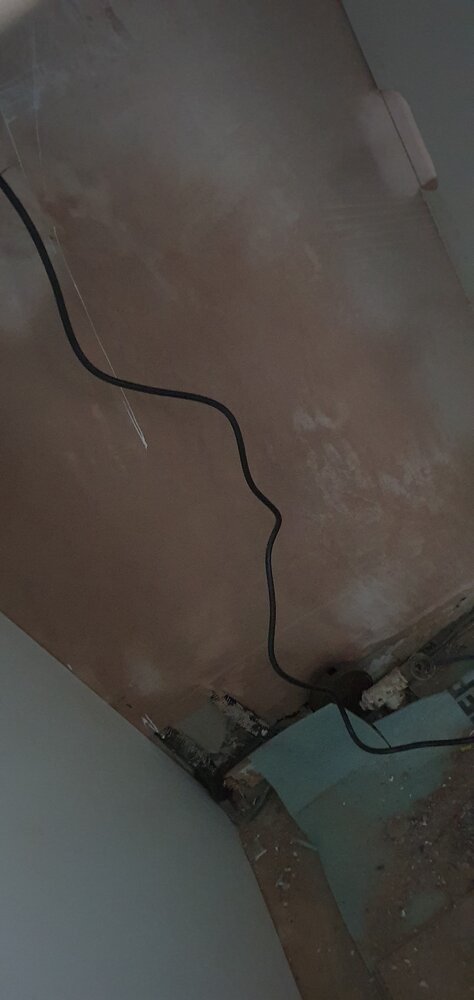

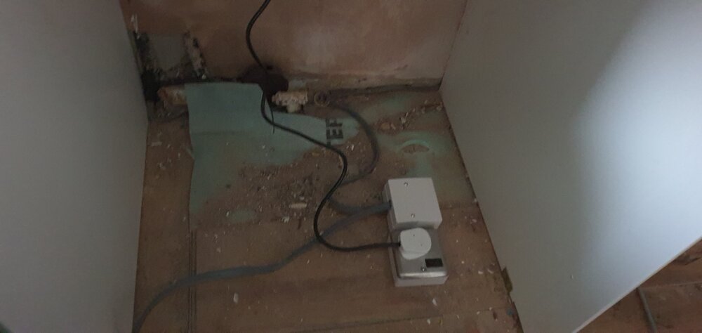

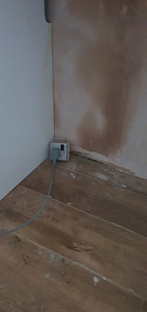

Update on works ongoing. Supposedly no need to fit two way fusebox, kitchen electrical appliances were safe enough to run off existing consumer board.
Not really happy with loose switch and socket that was left behind tumble as per picture. Also unsure about socket which has been attached to flooring under the new double oven.
Looking for advice please.

That loose socket on the corner is atrocious. Should be fixed to wall and the cable clipped to support it.
I genuinely didn't know it was like that until I pulled out the tumble dryer. I have been in touch with the joiner who was dealing with the electrician who done the work, as I'm extremely annoyed about this.
Is the socket that has been attached to the floor ok, or should I be concerned about this also?
Thanks
