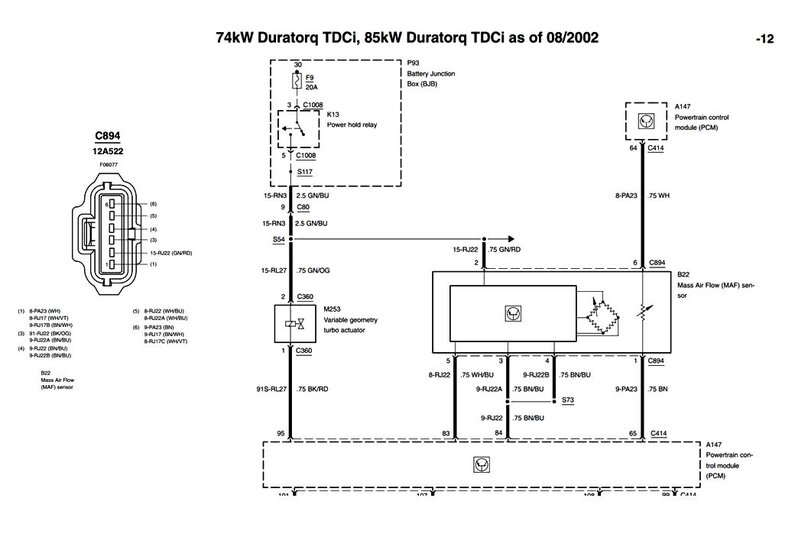

I have no idea about MAF sensors but your wiring may be like this (this is 2003 so it may have changed)
If the colours look right then for the missing two wires you should be looking for a brown wire with blue stripe that may be joined to another one as they are linked.

hi, thank you for trying to help me.
But, as I said, I have a 2006 Focus and it is the MK 2 version that I have. that diagram you posted was for an MK 1 version of the focus, an older model whereas I have the newer shaper model.
also I don't know anything about cars at all really, but by looking on that diagram I cannot see where it tells you the color sequence of the wires or anything ?
To be fair some models change during their lifetime and no wiring diagrams can be deemed as accurate as alluded to by PEG in his articulate and accurate post.

On that diagram
Pin 1 Brown
Pin 2 Green/red stripe
Pin 3 Brown/blue stripe
Pin 4 Brown/blue stripe
Pin 5 White/blue stripe
Pin 6 White
You need to go to someone who is clued up on this model and has access to the appropriate diagnostic equipment and relevant diagrams ,and has the mechanical knowledge to correlate between the two; in the light that yours is now an unknown quantity by interference of an unsuccessful third party ;to put it kindly.
