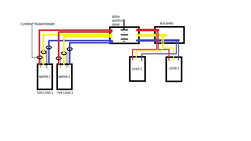

could any one explain how this system works
there is 2 three phase meters, from there iv traced the cables to (1) 800a switch
how do the meters measure the 2 different loads??????
i have done a quick drawing
please see attachment
thanks
paul

That cannot work as drawn, the Cts need to be either around the supply lines to the individual loads, or if more than one supply is present around the supply lines themselves.
The voltage inputs to the meters as well as the meter supply itself (as opposed to the current inputs) may be before or after the isolator, or even commoned where one supply is used
0.9 out 0f 10
They can't be connected as drawn and work.
The tracing must be slightly out
this was my conclusion, thought i might be missing something. will have to do some investigations lol
Is there a summation meter linked in?
If not you’ve totally cocked your interpretation of the system up.
There's no way that can work as drawn. Do the meters actually have a 3 phase supply and are the CT's located as shown?
yeah what iv drawn is what i can see..... common seance tells me this can not work but it is lol there must be something im not seeing. will have to go back to factory and investigate a bit more
