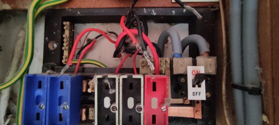

I do seem to pick only the weirdest properties to inspect...
Victorian terraced house today - with up front RCD to a Wylex fuse board and main bonding all in place to current standards....
No cpc on lighting, but all pendants and plastic switches - so far so fairly standard.
Then remove the CU cover and find this:
I'm guessing somewhere originally early 60s given the lack of cpc and tinned stranded connectors?
With 2 main issues:
1. Kitchen feed run from CU (30A 3036) in 6mm T&E (probably to an old cooker feed) - and then kitchen sockets run post 2005 in 2.5mm twin and earth.
At first I thought it was a lollipop arrangement, but not even that when testing at the sockets (No ring in sight)
Even so, that can be sorted for now with a drop to a 20A plug in MCB - not ideal for a kitchen with oven, but it's only doing 2 double sockets and a dishwasher in addition....
2. The rest of the sockets (only 1 in most rooms, with 2 in master bedroom) though are run in what I guess would be called "Twin" from another 30A 3036 - 2.5mm (imperial equivalent) with no earth. Perfect continuity of live conductors and when checking at the (very few) sockets - each one has a separate earth run to it, in bare twisted tinned copper imperial somewhere between 2.5mm and 4mm from eye.
Zs is fine at each socket, but the earths do not appear to run from the CU, so not possible to do R1&R2 at each socket. R1&RN fine at each socket though.
A RFC would have 2 x 1.5mm CPCs at each point - this has something akin to that at each point in a single conductor, with unknown source, but zs tests suggest adequate to deal with the short fault currents liable to occur before the RCD cuts in.
So do this count as a C2 for not having cpc continuity on a RFC - or is not technically a RFC but a hybrid that is non-ideal but safe? or in need of downrating to a radial to be safe for continued use? Or a C2 regardless of the OPCD?
How would you code that little lot?

RCBO board would fit nicely in the cupboard, replacing the up front RCD with an isolator switch, but not entirely happy reconnecting wiring with no CPC to a 'new' install - and I don't really want to do the rewiring job (it's not that local).

Baffling! someone has gone to the trouble of replacing the meter tails though - Brown and Blue (Not 60's)!
Probably C3 as there is evidence of some sort of earth connection as you've managed to get a Zs reading at the socket outlets, otherwise C2

Was there ever a period when 2.5mm equivalent 'twin' pvc without earth would have been used in domestic? I'd have thought by the time PVC came in (post 50s VIR?) that earths on sockets were very much a requirement already?

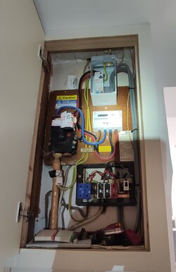

No idea where the earths run to/from though, it certainly wasn't visible in the meter cupboard, which had an RCD installed and meter tails upgraded, along with main earth and bonding, at some point...
Seems to have been done properly too (though no date visible on the installation sticker). Meter was changed 2015ish it seems.

FI makes sense - except I'm not sure how one would get the information - the downstairs is fully hardwood/laminate floors, so no floorboards to easily take up. The sockets are surface pattresses attached to skirting boards, clearly where original single sockets would have been so it would appear it may have originally been installed like it.
Can you physically see it is a two core cable at the consumer unit.

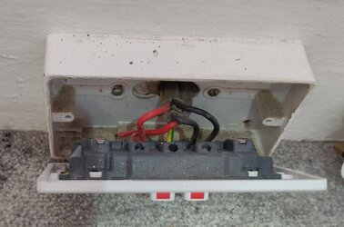

yes - it's 100% 2.5mm (imp equivalent) twin with no earth, not cut back short or anything.
Not a great picture - but this is at one of the sockets...
The cpc runs in separately through the skirting board as bare tinned - then sleeved (but only one feed at the sockets I checked, not looped in/out).
R1+RN was exactly as expected and in line with R1 and RN of 0.19... Zs tested as 0.87 maximum (on an extension lead run from behind a bed with someone in it so couldn't investigate fully....), but more like 0.38 ish on the ring - Ze was 0.15, so it all makes some sort of 'sense'.
IR on that circuit (L&N -> MET) was 30+ MOhms, though not sure exactly what that proves.... I wasn't able to completely isolate everything.

It is possible to prove a connection to an extraneous part and probably not that difficult with so few points. Isolate power, remove the earthing conductor and all cpcs at the consumer unit but leave the main protective bonding in place. If they have a boiler or immersion ditch the cpcs at the isolators then do a continuity check to the bonding.

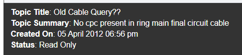

I knew I'd read of this before once.
EDIT doesn't seem to let me link to an IET forum article....
Some interesting comments about the span between metal conduit and the earliest PVC, apparently the cpc's were sometimes connected to the conduit using a threaded earth coupling.
1957 is suggested.
1957 is suggested.
