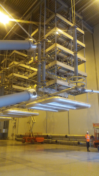

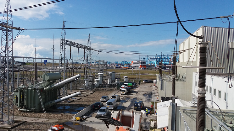

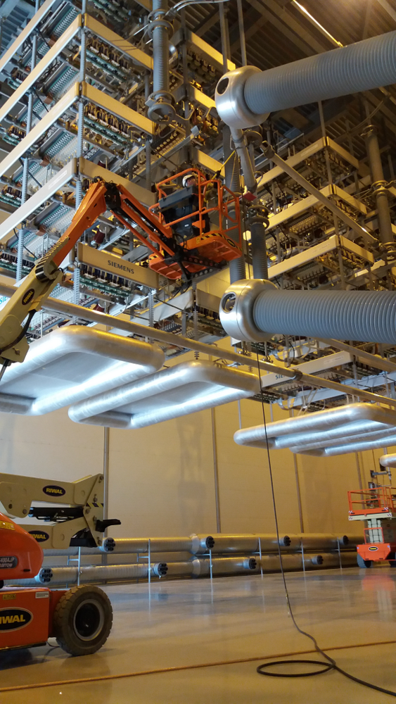

Things have definately advanced since Edisons days. This is a AC/DC converter station
I doubt he would even recognise the transformer. The spare Tx is on the left. Looks more like a gun turret off a ship.
Haven't got a clue. I don't work on the inverters apart from disconnecting them. I'm on the transformer side of things.
Moley: Could you tell us about any special features of that transformer to feed our curiosity? For example a feature of its design or technology or control/protection? How much do they cost to buy?
