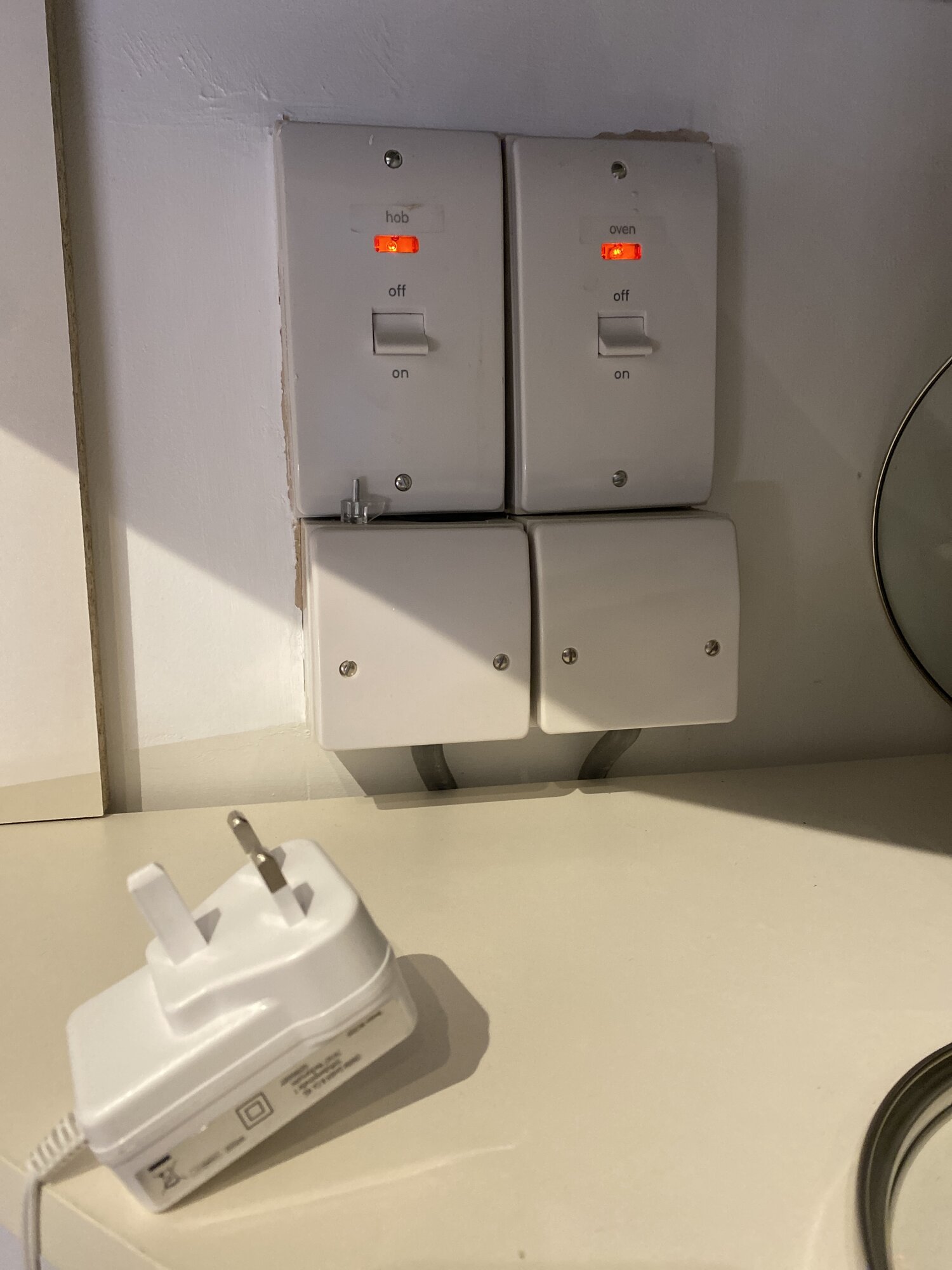

It’s been a year after the kitchen has been competed and now I’m looking at doing led strip lights under the cabinets on the plynths.
on one side of the kitchen I only have available 2 cooker isolating switches that I wired in for the induction hob and the electric cooker.
My plan is to spur off the outgoing of one of them in 6mm to a single socket immediately below them and plug the led lights it. They are 0.7 Amp zigbee lights.
is this ok? My only worry is an I correctly fusing the spur and would need an extra fused spur between the socket and the cooker switch. I can’t wire the led straight into a fused spur because it’s a molded plug with a transformer in it. I’ve added pictures for help
