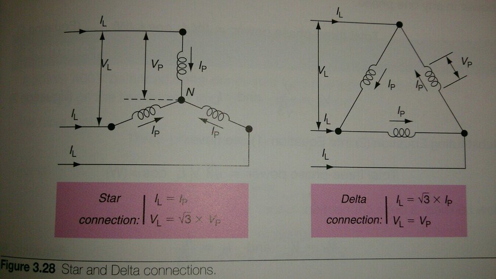

Evening all, could do with a little bit of help with regards to star and delta calculations. I have 3 questions and have attempted them but I have a feeling I have got the delta part incorrect (haven't covered all calcs for that yet)
I have posted the questions below and if any trained eyes could give me an opinion it would be much appreciated.
Cheers
Q1) A three phase star connected supply feeds a delta connected load. If the star connected phase voltage is 230v and the phase current is 30 A calculate,
A) The line voltages and line currents in the star connection
Phase voltage UP = 230V
Line voltage UL= Phase voltage UP x 1.73 230 x 1.73 = 397.9V
Phase current IP = Line current IL 30A = 30A
B) the line and phase voltages in the delta connection
UL=UP 397.9V = 397.9V (originally had 230V but read the question again)
IL = IP x 1.73 30 x 1.73 = 51.9A

All looks good to me! :)
Sounds like you've "got it", but the following is a useful reminder from the Trevor Linsley Level 3 book, page 121:

All the rest checks out but this bit is slightly off.
The line current has been stated to be 30A, since it's a star supply and delta load. Therefore to find the phase currents in the load you would divide by root(3) for a phase current of
IP = IL / 1.73 = 30 / 1.73 = 17.3A

So I have the line current (30a) not the phase current as I have worked it above. I see what you mean and agree with that.
Question b is actually )the line and phase voltages and currents in the delta connection. (I missed a bit out not that I think it matters as I did cover them all)

Yep, well spotted :) Oops. :)
I made the fatal error of not drawing it out.
