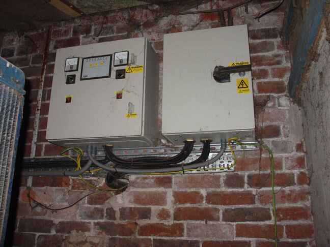

A 73kva diesel gen-set lives in the adjacent building to the intake
Altho its not been started or serviced for 3+years, farmer wants it incorporating in new arrangement, to avoid down time with his expensive new dairy. Not all that familiar with gen-sets, but doubt ATS or controls will be rated above 100a of original install & certainly not the 200a of new supply. So, with a max output of 100a anyway, it`ll only be able to provide back-up for the new dairy alone.

As said geney needs a good going over, maybe even an overhaul and incorporating via changeover switch etc. Myabe even think about auto seqeuncing for start up immediately on mains failiure.
Loading needs cosideration, particularly on the geney....dont want to end up with a pile of molten metal do we.:D

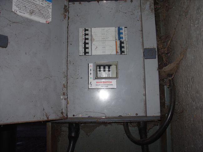

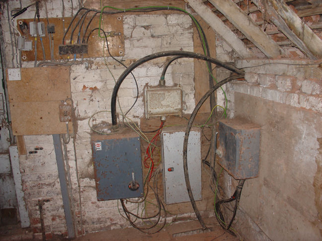

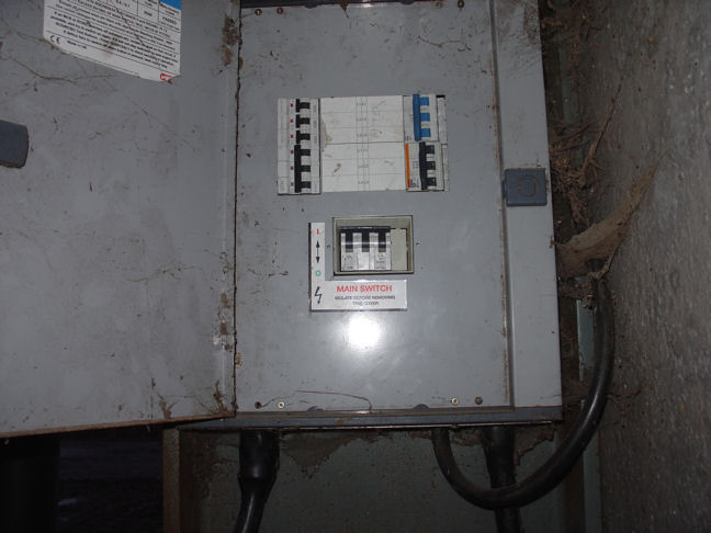

Overhead supply attaches other side of cut-outs in first pic (tapped off before entry to feed overheads to houses)
Thru cut-outs (red got a bit warm at sometime me thinks) down trunking to meters & second set of cut-outs in room below, back up trunking to henleys, where it splits off to left to

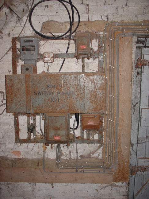

...which seems to be serving a few lighting circuits & not much more these days.
Main feed comes out of henleys (all the following in single insulated tri-rated 25mm) thru floor to lower level, thru wall into adjacent gen-set & changeover switchgear, back into lower room, up thru floor & into Mem iso lower right of 1st pic of original post.
Exits (still in 25mm tri) into middle (silver) DB, splitting then off to left hand Mem, & also up to Old Bill (check out the seperate Neutral straight out of the Henley!)
Quality!

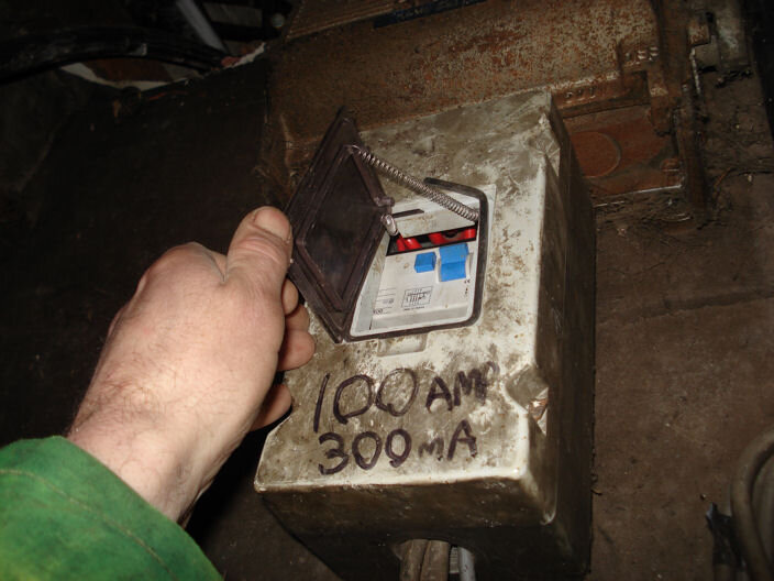

Aswell as feeding the grainstore (metal clad 1363 s/o`s & IP30 DB inside) turns out the board also serves large industrial cement mixer (recent). More horrors re this DB later.
The old 3036 Bill appears to feed the remaining loads thru-out the farm, via that 16mm swa out to more shanty town overheads, ping ponging from one out-building to another before arriving at the old dairy, where i actually found the first token of earth fault protection in the whole place
Lucky it weren`t a ELCB...

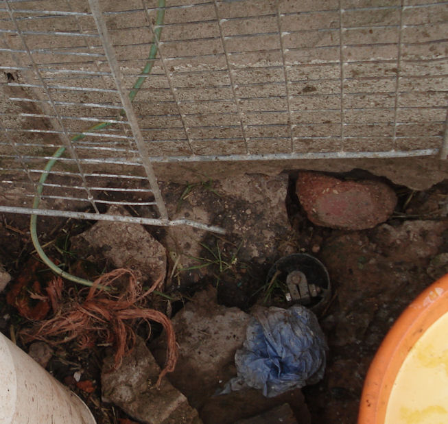

As to the use of steel structure as earthing, its unfortunate that its not at source - yet to confirm the validity of main rod within GenSet building. Looks a bit better than the rod in my earlier post tho. But the steel structure of new dairy will have to be bonded, as with everything conductive within it, so will actually become the most effective earthing point in the whole install no doubt.
