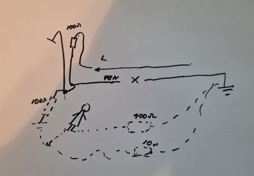

Sorry about responding a bit late to the party, I haven’t been on-line.
Sorry if it wasn’t too clear – I will attach a few pictures to try to explain.

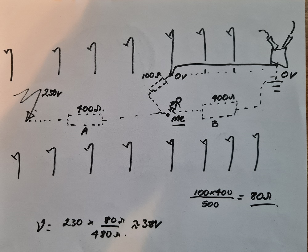

Firstly, if we didn’t use PME or any bonding to the ground, then each case would look like this:diagram 1.jpg
In this case assuming we are say ½ way along, and the earth impedance is say 400 ohm each side of the lamppost then the potential of the ground at the point of the lamppost would be around ½ of the fault voltage – so say 115 – 120V – if we touch the lamppost – which is held at zero then we have a 120V shock hazard!
If we now bond this lamppost to the ground – say by a 100 ohm connection then the fault current would go through the 400 ohm (A) and then both the 400 ohm (B) and 100 ohm in parallel.
This time then the voltage would only be 38V or so – so a much better situation.
Obviously, there are cases where the earth impedance is lower, but then the earth rod resistance would be lower as well, but for close up situations, it’s possible to get cases which aren’t much better than no bond at all
In practice however we would usually have many similar bonds to ground similar to the picture below

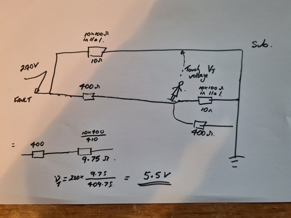

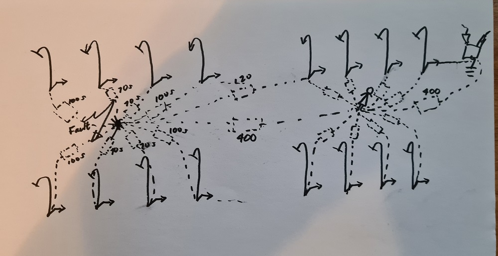

In this case, each point, such as the blob in the centre has a resistance to all the earth bonds around it, the closer ones may be 70 ohm, further ones 120 ohm etc – but if we take an average of 100 ohm and there are 10 of them, then the overall is around 10 ohm; however the real advantage is the effective isolation of each point from more distant ones:
In this case each the two example points end up fairly disconnected from each other – a mini near equipotential zone – in this case the equivalent circuit would look like this:
This gives a touch voltage around 5V or so for the same fault and ground resistance as the simple examples above.
Now, as has been pointed out, these aren’t true equipotential zones as any resistance at all would give rise to a voltage drop, but this is the case throughout all of the real electrical systems – even if you use 10mm^2 to bond everything throughout a house, then there will still be some resistance, and therefore some voltage drop in the event of a fault, but the regs generally use “substantially the same potential” as an EP zone/bonding criteria.
The next issue is the loss of a PEN, so with 500W this would represent a load resistance of 100 ohm or so, our situation would be this:
Effectively there would be a potential of 230V on the body of the lamp, however with the 100 ohm earth rod, it looks like this and we would have around 115V touch potential.
Although this is no good – it is better than having no earth rod, not worse.
Obviously all the above is just an oversimplification, but it illustrates that multiple bonds to ground gives both low overall resistance to ground, plus areas that form equipotential type zones - fairly disconnected from the influences of other areas forming similar zones.

Am also late back to the party! You put a lot of work into that reply. Appreciated. Have gotten through most of your calculations and they speak for themselves. You have demonstrated your point that it's better to have an earth rod at the base of the streetlamp than not have one. In your illustrations numbers 5 and 6 (dealing with open PEN) you demonstrated that the touch voltage at the lantern would be 115 volts instead of 230 volts.
I struggle a little however with some of your assumptions.
Firstly 115 volts is "better", but is that acceptable ? , safe? If the lamp wattage is reduced, will the touch voltage not rise higher again?
Secondly to describe the above situation as an "equipotential zone" is employing the term in a way I have not seen before. "equi" meaning equal or same. Its sometimes referred to as a "safe zone". The term conveys the idea of safety in people's minds, sometimes defined as an area where electric shock won't be experienced. I appreciate that you are perhaps implying a "more equal zone" but its important to make the distinction because of the mistaken belief (come across it here in ROI frequently) that the neutral can be "tied down to earth" via a 100 ohm rod. Your own calculations demonstrate that there will actually be a significant PD at the rod.
One final point that has me a little confused is the example you gave of the drunk touching the lantern and receiving a shock coming from the ground which flows back to the substation via the street lamp. Is the drunk not standing on "earth" while also touching "earth" (the street lamp is earthed)? In theory there should be no PD there?
The region very close to the rod (how close depends on the depth of the rod, etc) will be pulled closer to the lamppost, so they should get a much smaller shock than the volts to true Earth.
Again it is not a magic solution, and there will be dangerous voltages possible, but it is definitely less dangerous with the rods!

Yes less dangerous. But 115 volts is still VERY dangerous. We seem to have adopted a "river with 2 crocodiles is safer than a river with 4 in it" type of reasoning to some degree here.
Remember this discussion started with the viewpoint that "an earth rod ties the lamppost to SAME potential as the local grounds". Julie, s own calculations disproved that.

You will find the link "pretty mouth" posted very helpful regarding the use of earth rods with EV chargers.
The point i was trying to illustrate, was that if there is no reliable connection to ground, then there would be a shock risk.
if there is a bond, whether the connection is made using a rod, or incidental via the foundations then that's the situation described where I include a ground connection.

Have you looked again at the scenario as originally described.? The drunk is standing on the ground when there is a rise in potential at his feet. Now in reality the earths potential is constantly rising and falling with respect to the live. But the lantern is also connected to true earth and hence rises with the ground. So I, m trying to establish how he is at risk of shock. Ironically we have been discussing quite a bit about equiopotential zones. Well true earth is connected directly to the neutral at the substation and the neutral is connected directly to the lanterns earth (TNC-S) so it should not be possible for the drunk to have a PD developing across his body (theoretically)

No, they do show that multiple earthing rods do bring the general situation to one of minimal potential difference.
The one particular time it doesn't is when there is an open PEN
The only options to solve this are either to not use a combined conductor at all only TNS, or to ensure that every single piece of metalwork likely to come in contact with line, neutral, or earth(cpc) must be bonded to earth with overall resistances that are approaching zero.
If we take your view that an equipotential zone must have absolutely no voltage differences, then it is purely a theoretical concept as no matter how solid we interconnect anything, in practice there will be some resistance.
