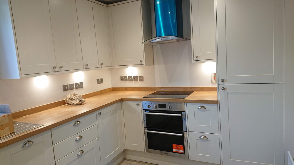

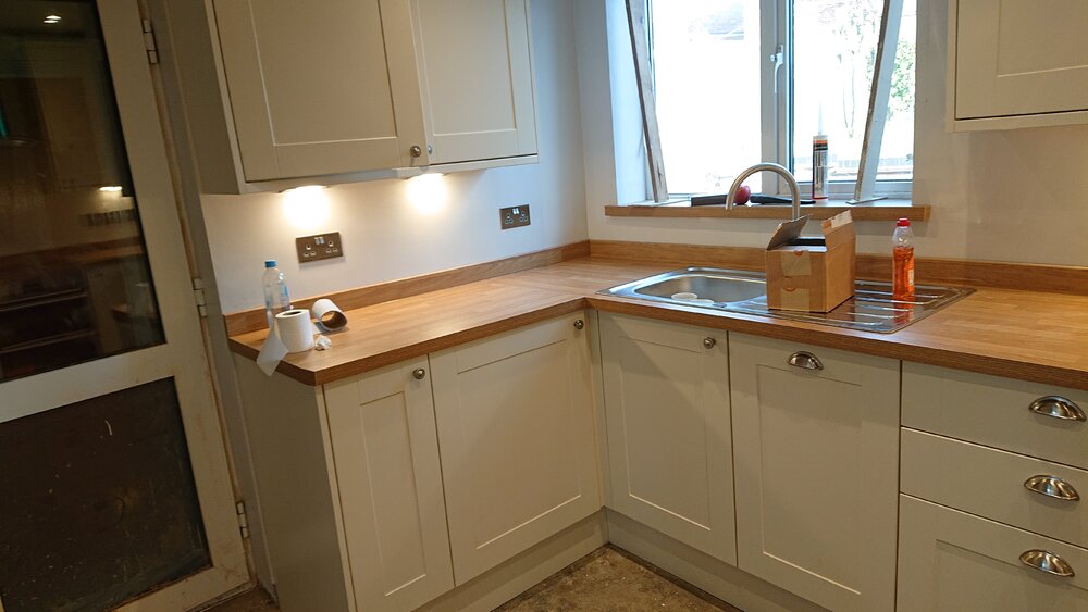

Hello, Is one circuit for kitchen sockets enough, the circuit will include, 1xfrigde freezer, 1xextractor hood, 1x13a induction hob 1xwashing machine and 1xdishwasher then just usual sockets for kettle, microwave and toaster etc.

Yeah there are isolation switches above the counter for all appliances and each circuit has an RCBO, the installation has been installed for over a year now just wondering if i've designed it poorly
That is a pretty normal kitchen setup of a ring and a cooker feed, with RCBO better than the more common single/dual RCD board.
In fact the accessible switches are not that common (but should be, and now part of Scottish building regulations) as a major advantage in fault finding or if something is making worrying noises or burning smells...
just wondering on the rating of the induction hob. might be a bit too much for being on the ring, considering other loads.
That is a pretty normal kitchen setup, with RCBO beter than the more common single/dual RCD board.
Thats good to hear domestic isn't my standard work so wasn't sure if long term it would be bad for the cables running all those appliances as I'm sure occasionally id be near the 32A mark, once you've got the hob washing machine kettle, toaster on etc.
