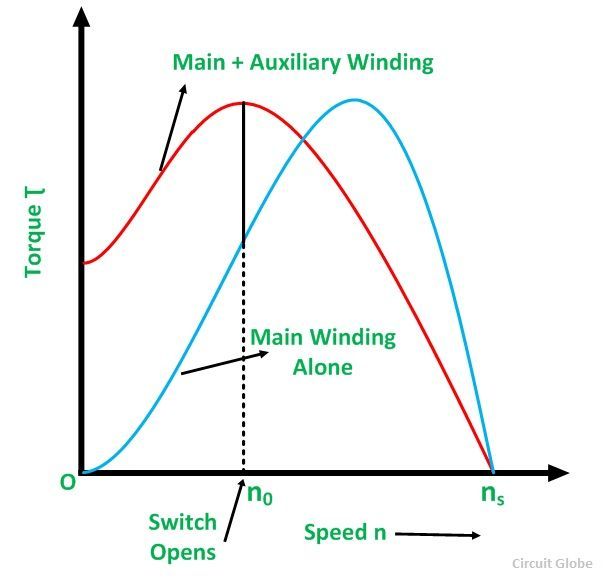

See if you can trace the wiring to come up with a diagram which looks like the star one on the right (Steinmetz circuit):
It doesn't produce another phase it induces a shift in phase to one of the windings effectively kick starting the motor.

am starting now to see where that "centrifugal switch" might come in
