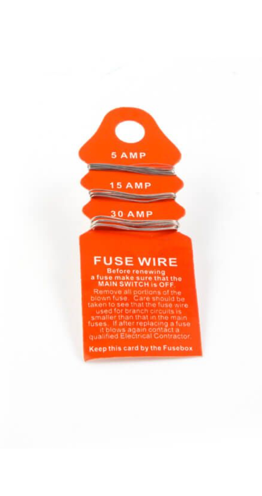

As above, there should be a length of fine fuse wire linking the two brass pins, going through the ceramic middle section.
If the fuse has blown that wire will be missing (or maybe two halves with ends showing solidified molten metal). Replacement is fairly easy if you have the correct wire (you can usually buy cards with 5/15/30A wire on them) and a small flat-blade screwdriver to loosen the screws that hold the wire in place.
