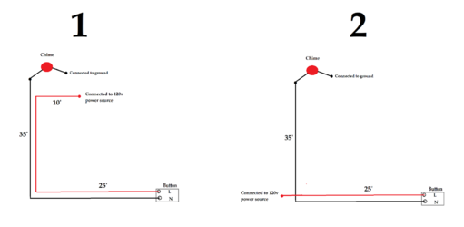

I installed a doorbell where the button to activate it is 70 feet from the chime. I thought 14 gauge would be enough, but when I pressed the button, no chime. I realize what a mistake this was. I've attached a diagram showing the ridiculous distance in number 1. Would it make a difference if I connected to a much closer power source that I discovered as shown in number 2? It's a Home Depot-bought doorbell - there isn't a separate transformer. The transformer is just built into the chime.

70 feet isn’t a huge distance, so shouldn’t cause a problem.
The wire on the doorbell circuit should not be connected to ground. It should go back to the transformer.
Can we see a photo of the connections on the chime, and the push button.

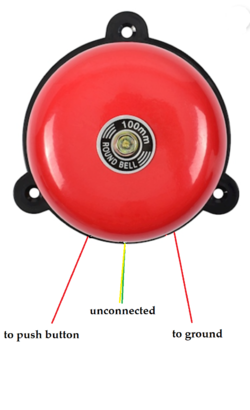

Thanks for the reply. I've attached a pic of the chime w built-in transformer and a drawing of the underside of the momentary rocker switch that will activate it (don't have the switch with me at the moment).

I may have just wired it wrong. I'm reposting pics that show my wiring configuration. I'm wondering if I should have used the green/yellow wire...?

Green/yellow is earth. What does it mean by empty holes on the switch, are there no terminals there it seems odd to connect across N and L.
