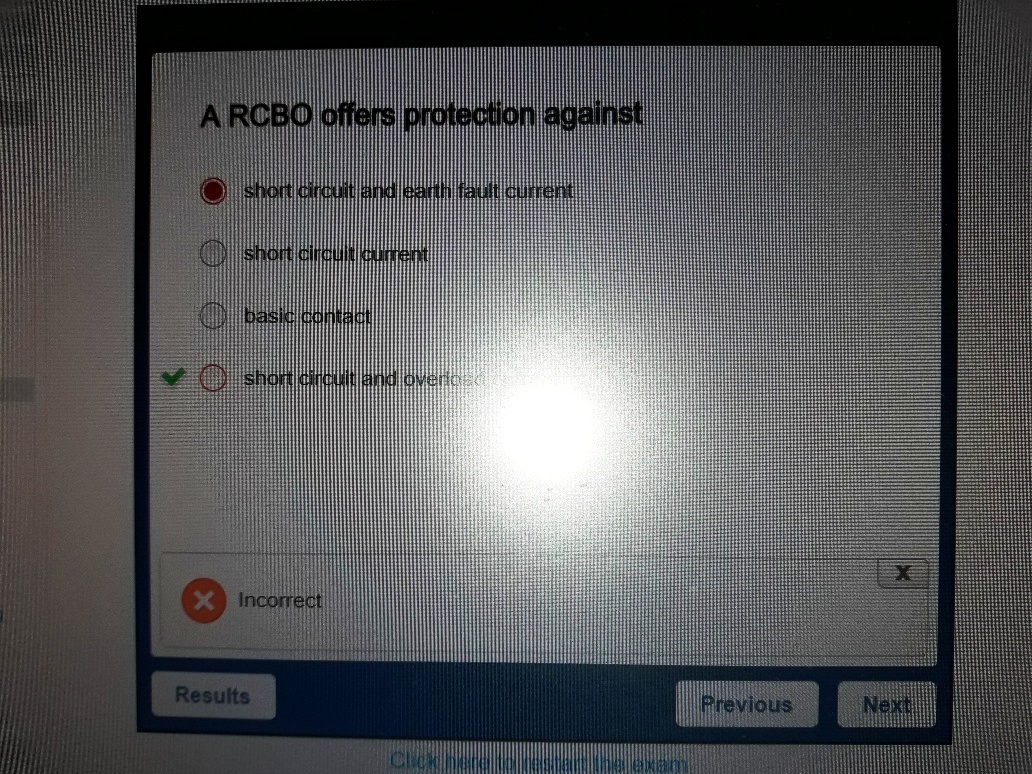

Booked in for my 18th edition exam, so I've been doing some mock exams online. Can anyone explain this one? There's me thinking an RCBO protects against over-current and earth fault current?

It does, and IMHO it's a really bad question. I remember that one from my exam and I'm now fairly sure I got it wrong!
I don't have BBB here at home but in the definitions section at the beginning does it have "earth fault current" listed?
It might be that "earth fault current" is more associated with "prospective earth fault current" in the regs, and answer one isn't technically using correct terminology in the mind of whoever wrote the question, in which case answer 4 is the closest.
But it's a definitely a poor question!
Sounds about right to me.
I think it’s just a poorly worded example question and for what it’s worth, I would’ve picked your answer too

From the BBB: "A residual current operated switching device designed to perform the functions of protection against overload and/or short circuit"
So it doesn't protect against earth fault currents??
The "residual current operated" bit means it detects imbalances between current flowing in and out of it, and any imbalances "switch" it, and therefore that includes any leakage to earth/ fault currents.
So RCBO's are a residual current operated switch that also provide overload protection.
I do believe you had this all correct in your mind before that question threw you!

It is a somewhat misleading set of answers as really a RCBO protects against:
  1. Earth currents (well below normal operating levels, let alone fault conditions)
  2. Overload (usually, though fixed loads such an immersion heater may not need it)
  3. Fault (i.e. short circuit style events) which could be L-N or even L-E so also an "earth current".
So the last answer in the multiple choice is actually correct as it is a sub-set of what it does (2 & 3 above). However, as @Mike Johnson points out the a**hole creating it has decided that wants to see 1 & 3 since 2 & 3 are also met by a MCB/fuse where as 1 is not.
Similarly a RCCB meets 1, but not 2 or 3.

Hi guys,
Looking at this question in detail, I would like to add my two pennyworth. I think the question was sound and correct. It is peoples mis understanding of technical terms that leads to questions being interpreted as not being correct. In part two (definitions) of the regulations it clearly states what an RCBO is designed to do. However could I deflect your attention to the table A53.1 on page 188 of the regs book. There you will see that an RCBO has functions to protect against:
Overload, Short circuits and Residual Currents
whereas an RCD (as one of the RCCB family) only protects against Residual Currents
and Residual currents are again described in Definitions part 2.
Therefore both protect against Residual Currents, but of the two only the RCBO protects against short circuits
Enjoy the Bank Holiday, I need to get out more.
Regards
JohnC

I disagree. Nothing to do with technical terms, it's just really badly put together. The question (or statement if you like) has 4 answers, 3 of which are correct: 1,2 and 4.
I'd have liked to see the word "includes" in the question, as to me that makes it much fairer.
"An RCBO device includes protection against"...
As it stands there is a hint of the absolute and a natural tendency to not want to choose the correct answer because it omits residual currents completely, which will also be in the top of the candidates mind as their unique feature.
At the end of the day the exam should test what people need to know in an uncomplicated way without trickery.
EDIT to add I do also agree that answer 1 and 2 are arguably correct, even if not using strictly BBB terms. (I believe it refers to residual current and short circuit conditions, but would have to check)
Bottom line it's just a naff question!
