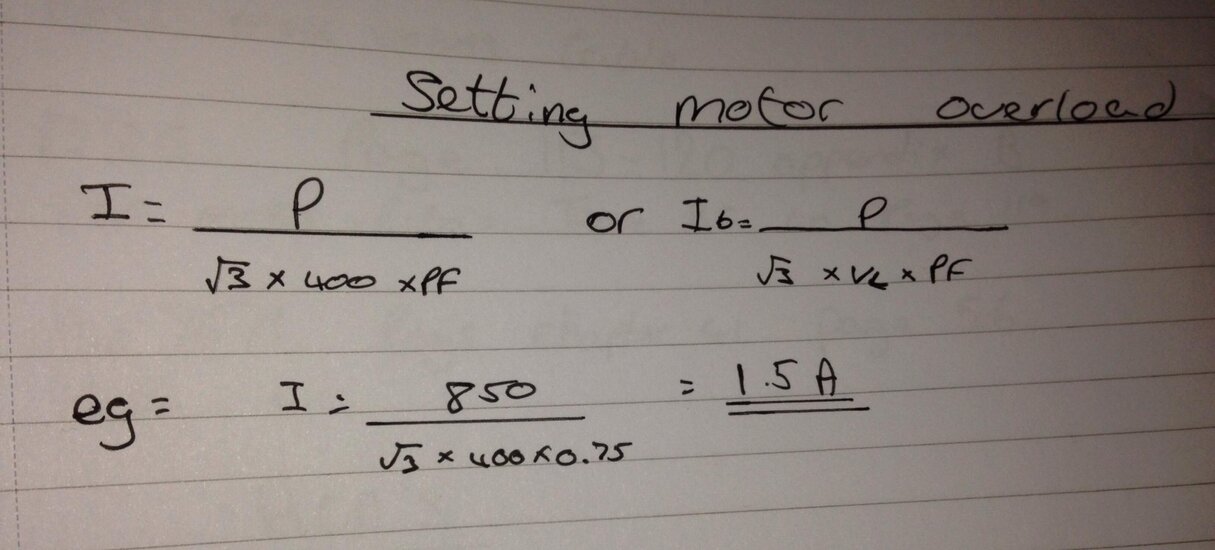

3. When working out the overcurrent for the motor, are you given the p.f and/or Vl?

Theres the formula pal
