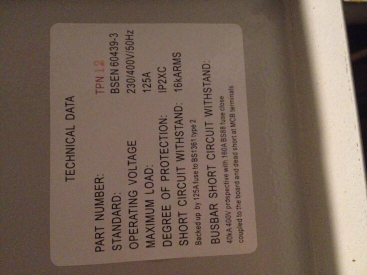

So im driving miles into the sticks to wire in a shower at a hotel, new circuit.
I ask the maintenance man to email a picture of the DB so I can get the right RCBO.
He has just sent this:
He is no longer on site.
Any clues about the brand anyone?
I know that it is a 3 phase board with spare ways, less then 10 years old.
Ask the plank for a make off the switchgear.
Typing in TPN12 as a part number comes up with Lewden/CGD/Europa. Rather you than me.

When I first asked him he said the brand was 'RCBO', hence I asked for the photo.

I tried TPN12 and got almost every brand out there then realised that it probably stands for 12 way triple pole and neutral.

It does.

Yes obviously TPN12 would describe a 12 way board of any brand, but the above mentioned brands (which I believe are all of the same ilk) actually use that as a product code for a TP+N 12 way DB.
With that being listed as the "part number" on the label I would say that there is a good chance of those brands being the ones.
I can see 2 trips happening tomorrow, more expense for them then.
I will take a random selection of RCBO's and see if I'm lucky.
