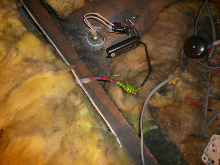

I got a call out over the christmas to a bungalow where the RCD kept tripping.
I had a quick look around and found that there was nothing plugged in, the lady had just bought the house and moved in a few days before but not yet brought her furniture etc. The fault was traced quite quickly to the socket circuit (IR reading 0.2!) and then we found water under the floor and joint boxes lying in the water. In the joint box was 2 x 2.5 T & E, which hadnt been cut, they had both had the sheath removed and then crossed over so in effect the ring was crossed!

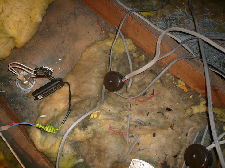

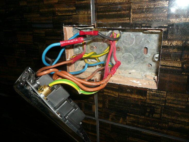

After a bit more look around we found that the ring main showed a ring in the kitchen, but in fact that too had been crossed somewhere and that ring was fed from a single 2.5 to another JB in the loft. 2 of the sockets had 4 sets of cables in! Some of the cables fell out the terminations as the cover was pulled forward! The lady had bought the house as the kitchen was fairly new and she thought the house didnt need any work doing to it!
At the same time the kitchen was fitted, they fitted new LV down lights and cupboard lighting! This was the first thing i saw over the kitchen, which says it all about the wiring in the house!
I explained all about the dangers and bad wiring practice saying that everyone needs to be Part P registered and comply with regulations. I was asked my advice on what to do and i said she needed the house rewired!

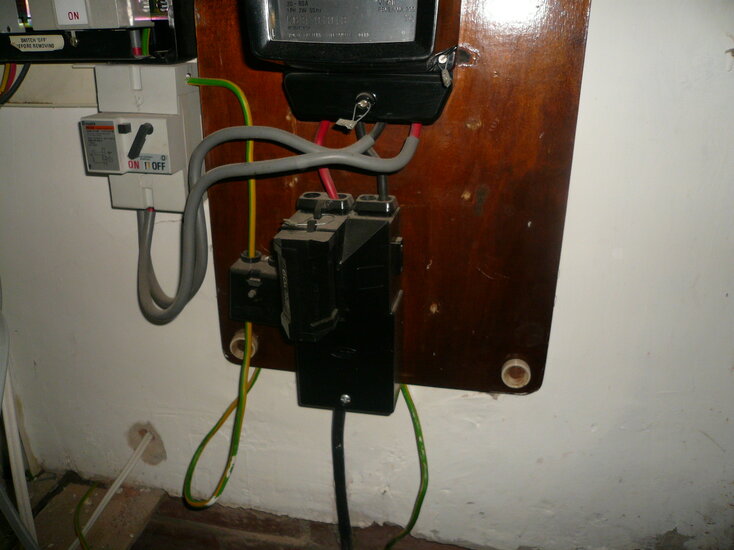

The first and most glaringly obvious point from the certificate, is that this so called registered electrician (who recorded his position as 'Inspector') is that he thinks it is a TNC-S system - hmmmm.... dont think so mate!
He also recorded the earth (that goes to the rod directly below the board) as being 16mm, when it is actually 10mm!

I dont know how long you have been a Spark, but you will see a lot of this, and most of it will be a lot worse believe me. this sort of stuff is common place in my experience, and yes some of it is by registered and qualified Sparks. Fortunately there are those of us who like to sleep at night, so we work properly. It is this minority that give the rest of the trade a bad name. all you can do is keep taking the photo's for you archive like i do, and sort out the mess. The worst job i have seen was by a DIY'er, he had spurred a radial off ring final and added 4 twin sockets wired in 0.75mm 2 core flex, the stuff that is on pendants all protected (or not as the case was) by a 3036 30a rewireable fuse, not an earth in sight. His comments "it cant be that bad cos they all work".
