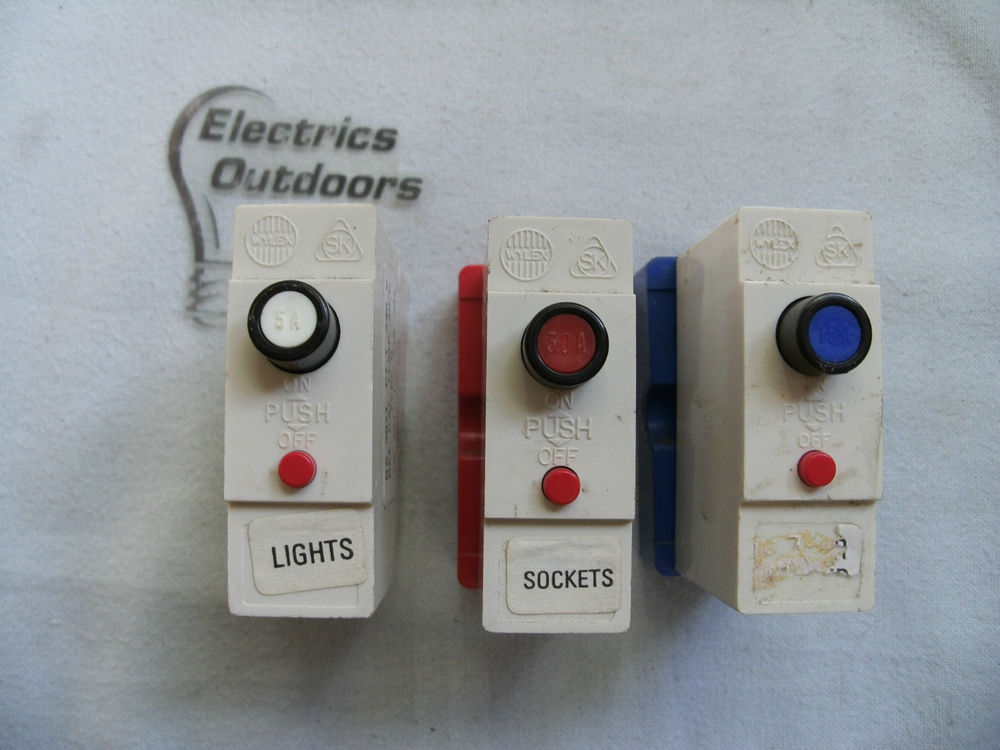

I took out an old 3036 when I did my first consumer unit at the weekend (under supervision) - I could have had that but thought it might be best to get used to testing on something a little more up to date. It had some of these - what BS number are they? (BS 3871 when I've done a quick search) Didn't think to keep them for a bit play about with.

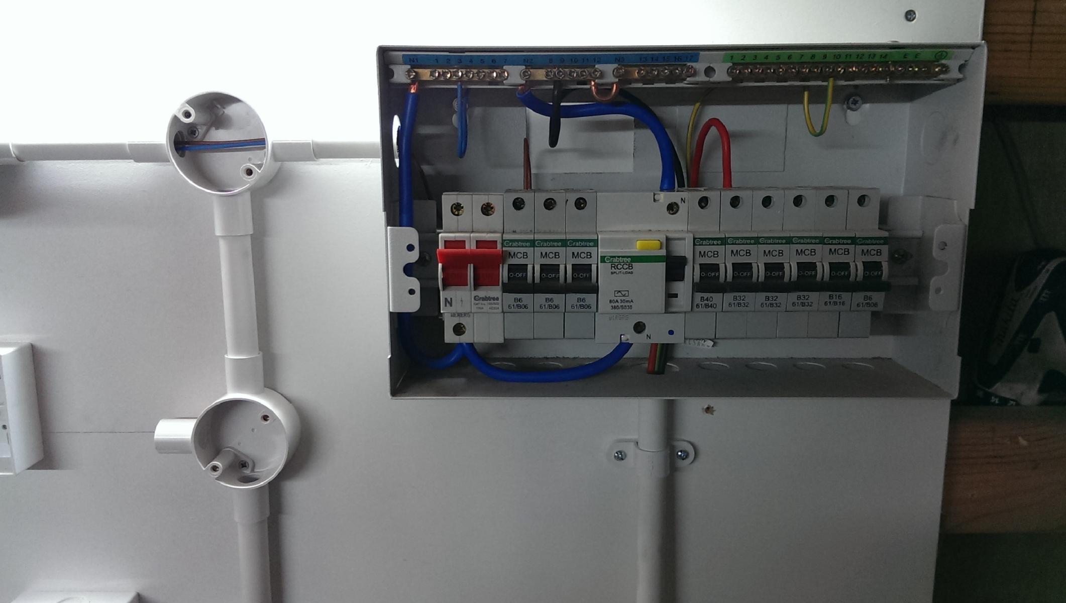

I'm only in Newcastle but I'm up and down the A1 a couple of times a week so a meet up on the way past wouldn't be a problem, this is the board..
That's awesome mate - Lee, is it okay if I take penny chew up on this offer? Just would save you having to post etc.
