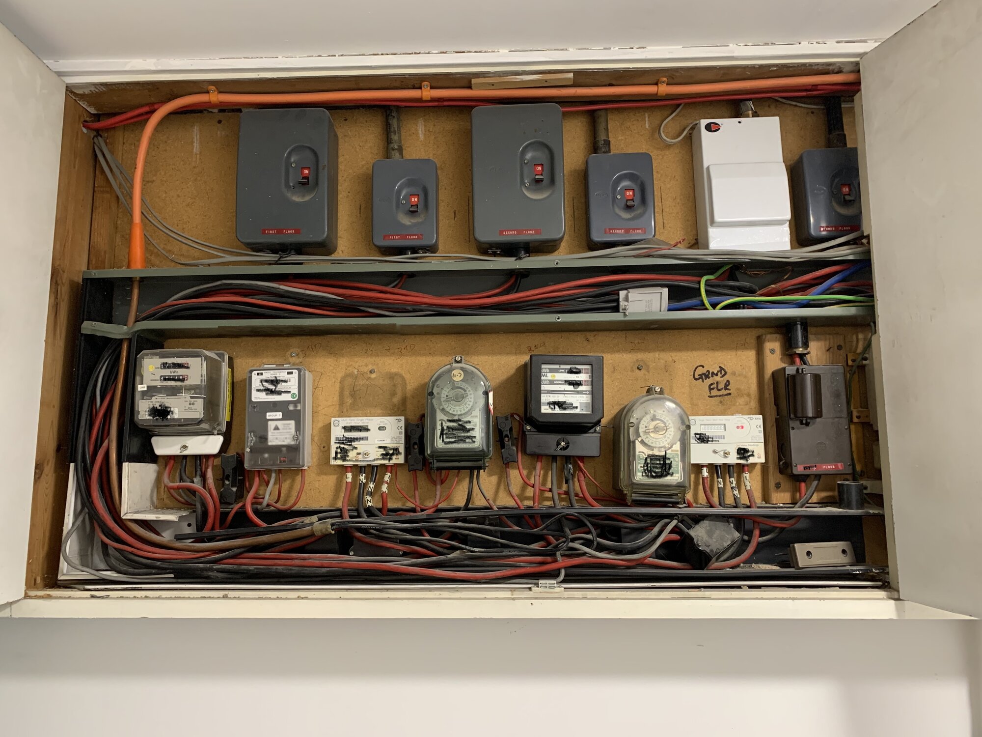

Thanks for the feedback so far, much appreciated. It sounds like a bit more detail would be helpful, so I've attached a couple of images and the detail from the electrician:
Each flat has its own meter, provided by your supplier. I need to remove the old cables that are currently supplying that meter to replace them, that can’t be done without their seals being removed.
The fuse seals are the property of the DNO, power comes from them into your meter. As with the meter seals, I cannot work on those cables without the seal being removed.
Over the years, at the hands of multiple electricians, the installation ( from the suppliers cut out to the armoured cables going to each flat) has been left in a condition that is not satisfactory. We intend to fix it.
To do so, we around need to run new 25mm tails to each isolator, replace the isolators and replace the trunking in which all of this is contained. This work cannot be done whilst live and would need the fuse pulled from the DNO cut out. These fuses, however, have a seal on to prevent them being removed, this would need to be done by the supplier.

To be honest I think you are fairly lucky to have found someone willing to take on that lot as it's a non trivial and high pressure job and involves liaising with lots of people.
As an aside this I don't think I've seen MICC terminated like this in mid-air before, and it leaves me wondering (mainly) about the earthing arrangements.
It's earthed in the normal way via the gland onto the metal trunking. They've just put the pot on it closer to where it connects to save stripping it back all the way to the gland and having long tails.
