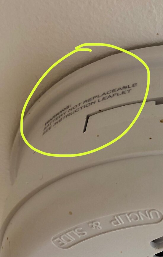

A customer has asked me to stop there AICO heat detector from beeping. I was about to give them step by step instructions to change the battery as it has an alkaline battery in it.
AICO instructions state how to change the battery therefore the battery must be changeable? It is not the lithium model. It is the Ei144RC.

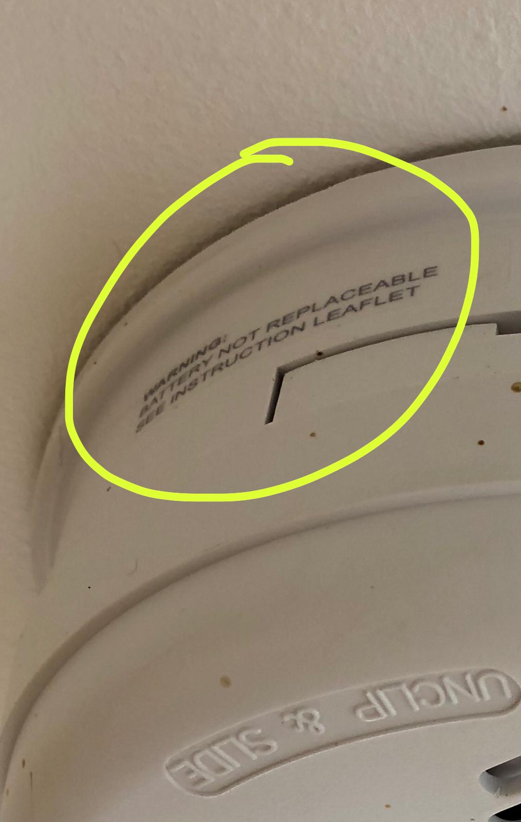

The customer has just sent this picture
I don't understand!
Thanks chaps! It's the radiolink base that has the sticker! I didn't notice that.
