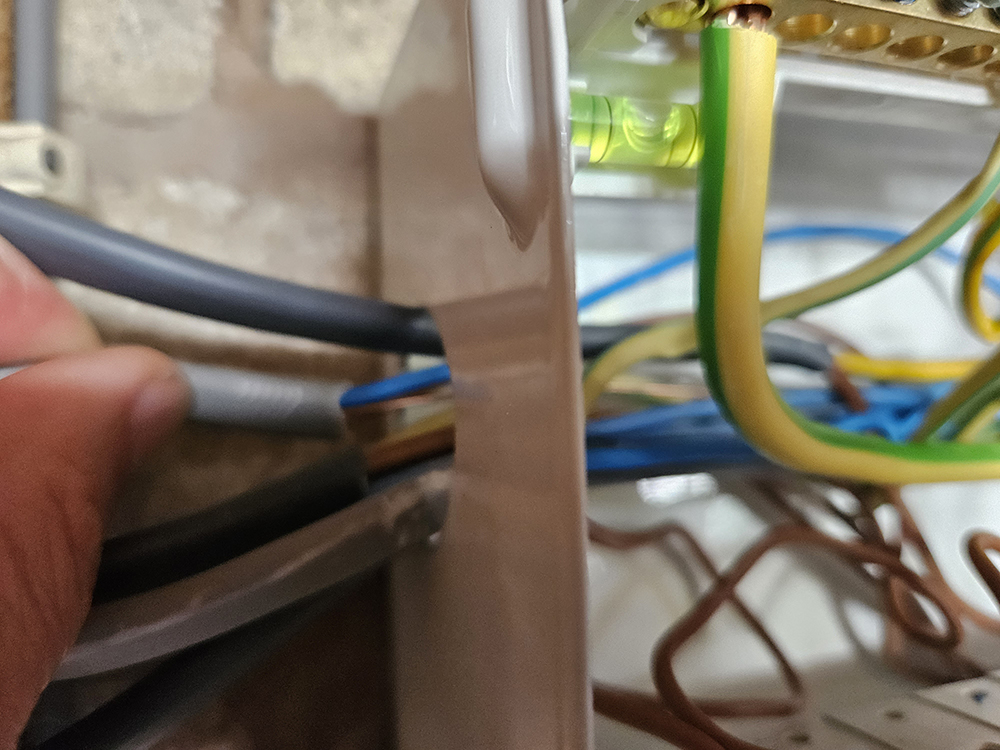

The additional unit is from the kitchen as they had a new kitchen fitted. My concerns are with the quality of the work. No glands are used and all wiring enters the side, the cables also have sheathing cut short so the wires are exposed. I'd have thought some simple chaffing could expose a wire and short the consumer unit:

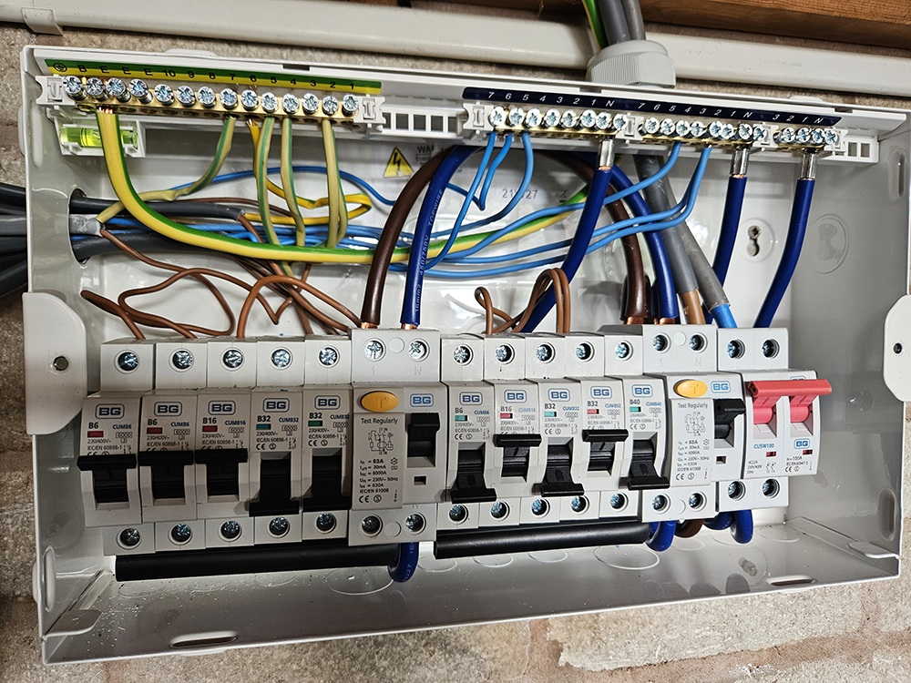

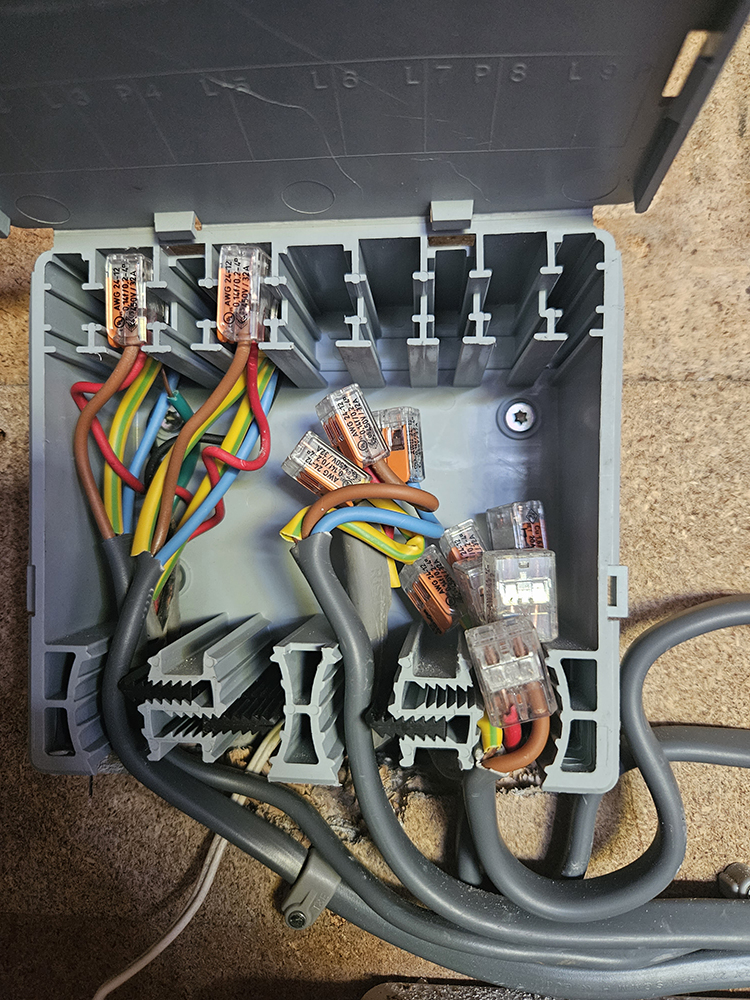

Due to these concerns I opened up the box to take a look at the method used to extend the wires:
I have a few questions here... why are glands not used? Is it ok not to use a DIN rail and simply extend all circuits with lever terminals? If so, would splice connectors 221-2411 not be more suitable? If the cables aren't long enough to reach a DIN rail, would it be best to use a Wiska Consumer Unit Relocator for any circuits that do have a wire long enough, and then extend the others?

It's rough but, provided connectors are able to handle the rated current of each outgoing circuit, there's no real issue on that front.
Cables should indeed be restrained and IP rating of enclosures maintained. The main issue, as you've highlighted, is cable sheaths and exposed insulation entering through a cut metal edge. There are a number of ways this could be resolved and glanding individual cables is one of them. To make the best of what you have, I'd probably replace the 2 gang surface box with a small adaptable box and run a short length of 2x2" PVC trunking between it and the board, which would provide space to place some sort of gromment over that cable entry.

Those Wagos are poorly connected, far too much insulation stripped from them. The bottom one appears to have two cpcs in the same sleeve into one terminal. It doesn't bode well for what the consumer unit contains.
Cut that box the get the cables out without dissing the wagos. Replace with a Wago XL box, which has cable restraint built in. Then tidy up the connections 1 at a time. Be nice to see a pic. of the CU wiring.

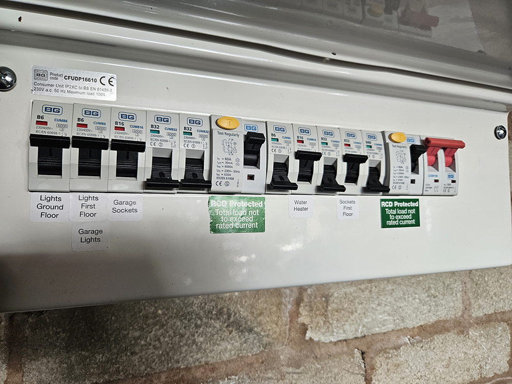

Here's the CU:
Seems ok although not the neatest and the grommet looks cross threaded:

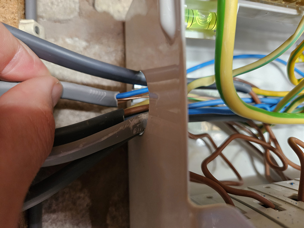

What was slightly alarming was the lack of sheathing on an earth cable in the side entry:
I've put a sheathing on it for now as a temporary measure until its sorted properly. As I unscrewed it, it was pretty chewed up where it joined the earth bar also:

I hate to say it, but looking at that chewed up earth, I fear every terminal was tightened with an impact driver. At an absolute minimum I'd turn the power off and look at the other CPC's (earth wires). If required trim them so you are biting on undamaged copper and loop the end around (similar to how the Neutral's are) so you get a better connection.
You would normally put the two lighting circuits on separate RCDs, so one RCD tripping doesn't plunge the whole house into darkness. But it could be done this way because of a borrowed neutral e.g. the landing light (L supplied from downstairs, N to upstairs) and they couldn't be bothered to fix that.
A borrowed neutral is required to be on one circuit rather than just one RCD though for safety reasons (which of course would no longer render it a borrowed neutral).
Pretty grim. I've spent time on it today to put new cables in and glands:
Still not perfect but have addressed the side entry issues. Unfortunately the cables aren't long enough to allow the Wago junction box to be used correctly, what's the best way to resolve this, if any?
Without seeing it for myself this is a bit of a guess, but I'd probably grab a 20mm holesaw and make three or four holes holes is the back of the top of the Wago XL box near the top, mark everything with a Sharpie and then feed the short original wires through the back of the box, resulting in the short wires being nearer the top, and the box being mounted lower down.
When done you should fit cable ties so no one can easily unclip the front.
EDIT you may have to flip 180 degrees so the wago's are at the bottom, and the new cables enter at the top
Out of interest, if I ever upgraded to rcbo's, I'm assuming these are all single pole aside from the 'sockets first floor' because I've found this is actually incorrectly labeled and it's actually sockets for both floors with two cables entering the one mcb. Therefore it'd require a double pole rcbo?
...or is it simply wired like that as its a ring and not a radial, therefore still a single pole rcbo
