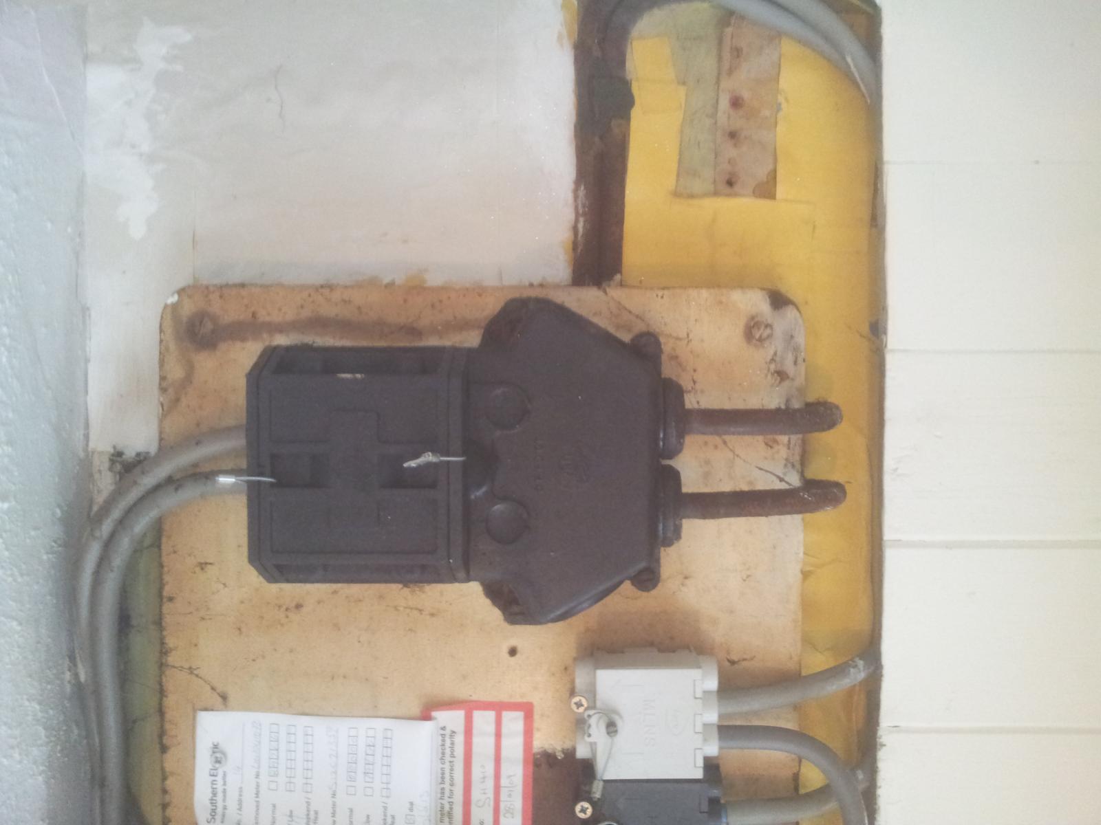

I will probably be changing the consumer unit that this cut out is supplying. I have not had to remove a fuse that looks like this before and was hoping for some information on it to help me decide on the next course of action.
Is this bakelite?
Has anyone any 'colleauges' that have pulled these with any bad experiences?
I realise I could remove the tails from the Henley block but i'd like to avoid doing anything live if possible, plus i'm interested in the cut out anyway.
Cheers.
Have pulled those before but know idea of composition. I'd be a bit wary of disturbing those VIR tails but shouldn't be too bad. I'd probably just drop out tails from meter or blocks tbh
i'd diss. from henley blocks. as long as there's no load and you work safely. don't use one of these:

Hi Steve, yes small me 60amp cutout, seal fairy strikes again then.? lol tut tut.
Reactions: 1 person
Thanks all, I think disconnecting from the Henley's is probably best. Just started a new thread about fitting an S type RCD where the Henley's are!
