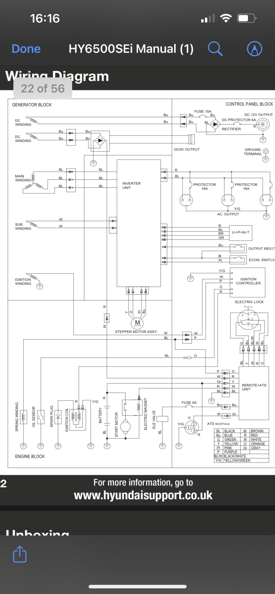

Afraid im going to have to dredge this one up again. Went to install the wiring for the generator today and all went fine until we fired it up.
No load connected to it I measured 115v between line and earth and also 115v between neutral (ok probably this is also line) and earth.
So it appears the genset has a centre tapped earth. Yet looking at the wiring schematic suggests it doesn’t. At that point I decided to pack up and seek further advice. I’m sure it’s a bad idea to supply a house with a supply with a centre tapped earth. Manufacturer claims it’s suitable for use as a standby generator though. Could do with some advice.
Can you IR at 250V the output L+N to E?
It might not be centre-tapped, it might just be equal filter capacitors from L to E and N to E for the electronic inverter part leading to a balanced output voltage when nothing asymmetric to E is present. After all the schematic only shows protection breakers in the L paths to each socket.
Thinking a bit more, that generator lacks and obvious RCD protection for socket outlets!
So either it is assuming as an IT supply it is safe enough (not sure how that sits with UK regs once several loads are present) or it has some electronic RCD-style shut-down in the inverter (so in effect an automatic insulation monitoring system).
That’s what threw me. I assumed the earth was not centre tapped after looking at the schematic before visiting site.
Wish I had thought to IR test. I’ll have to do it when I go back. Should I assume I will get ‘open circuit’ when testing between L&N to earth if the earth is not centre tapped? In which case I can just link N and earth in the output socket on the generator and happy days?
Alternatively if I get 0.00 Mohm then it is centre tapped. What are my options then? Assume it’s get them to return the generator or modify it somehow by disconnecting the centre tapping. Neither option is appealing!!
Appreciate the reply. Thanks
