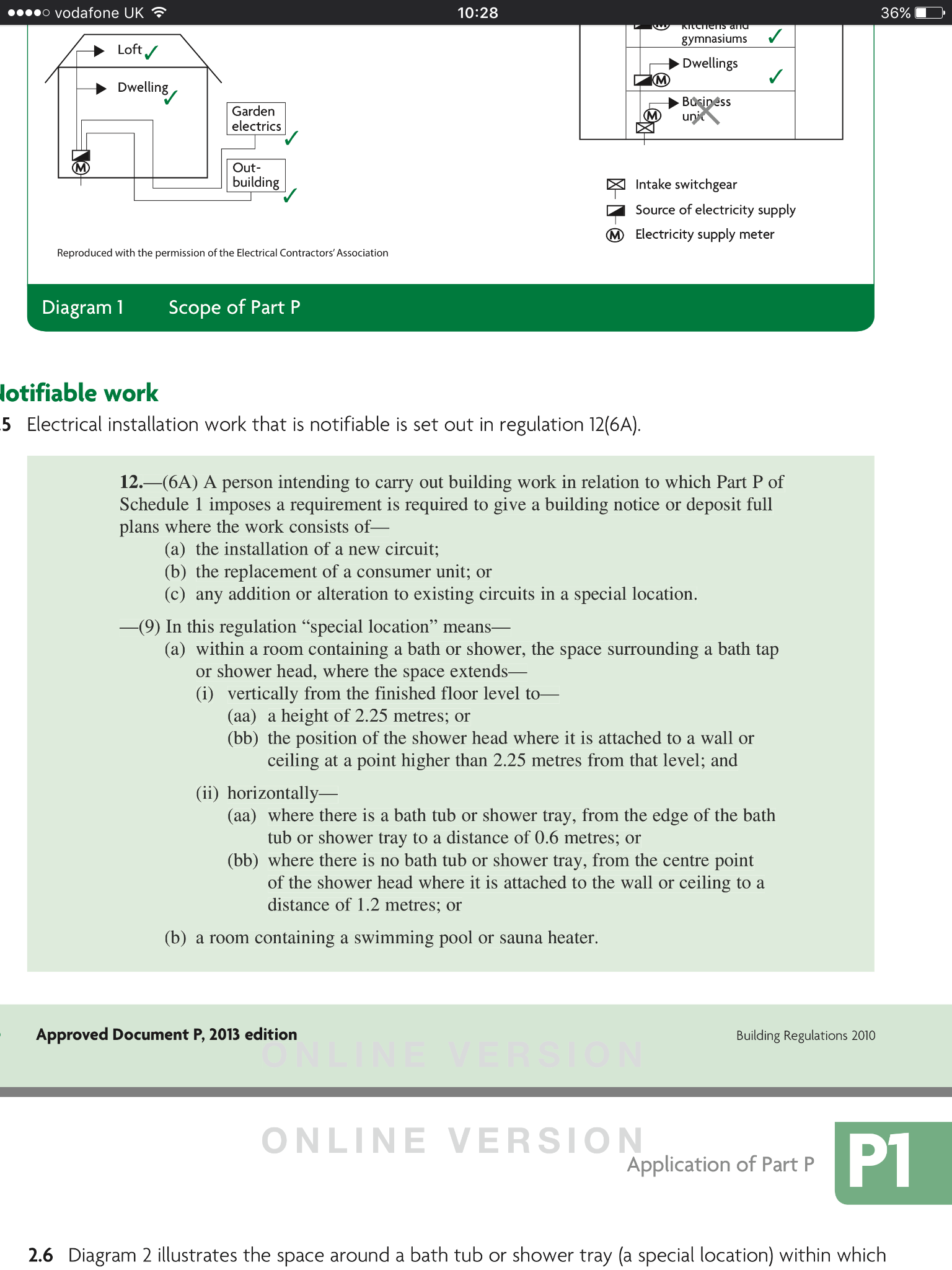

Isn't it true that any electrical work in a bathroom is notifyable?
No, as far as part P is concerned the special location is only a zone around the bath or shower.
Part P only defines one zone where work is notifiable, see my post above.
I haven't checked to see whether this aligns with the zones in bs7671 in any way.
I find the easiest way to avoid confusion is to just not do domestic work :)
I avoid any work now Dave, other than what her in doors want's me to do.
part p notifiable work covers zone 2 as well as zone 1.
