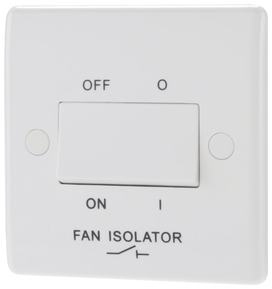

Out of curiosity, do you know what make/model you got?
The most recent one I bought was, I think, one of these:
https://www.NoLinkingToThis/p/briti...solator-switch-white-with-white-inserts/69862
It was easy to get and actually labelled as "fan isolator" so others would know its purpose in life!
[automerge]1589052992[/automerge]
On second thoughts it was rounded edge, so maybe this one:
https://www.NoLinkingToThis/p/briti...solator-switch-white-with-white-inserts/928ht

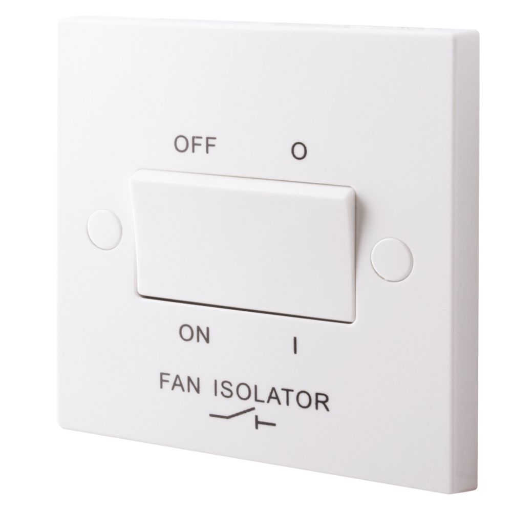

Thank you PC1966 for your advise. Funny enough after reading Dave's comments I went online & purchased the exact same model from screwfix. Though I had to buy the square edged version as the slimmer profile was out of stock for collection today.
Thank you again
Best regards
Hopefully that is now a quick and easy fix!
The wiring is straightforward just as you originally identified, typically with the earth joint as part of the back box.
