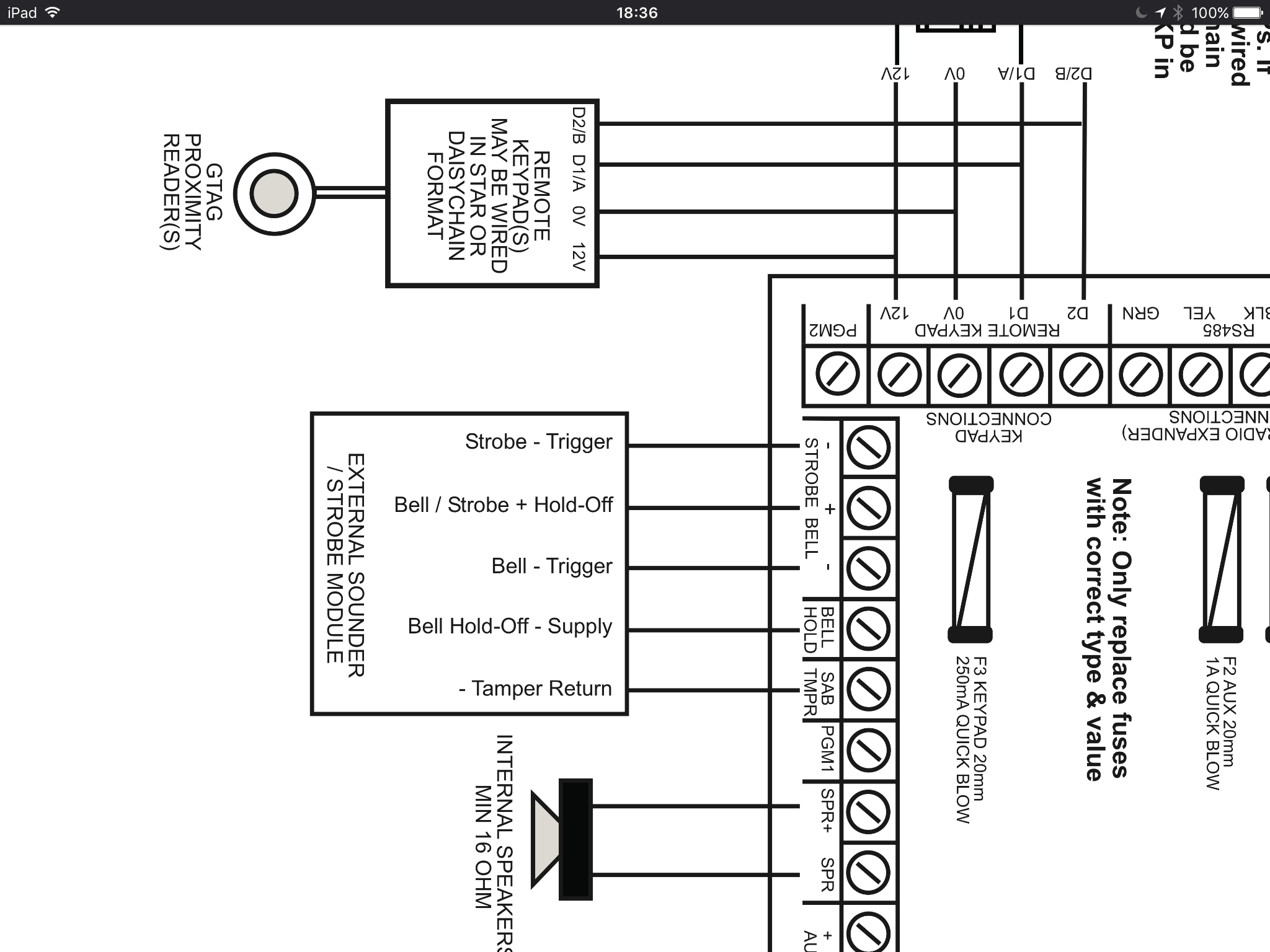

hello would just like to say hi & to a great site, being doing electrical work for years now retied which i like even better, now just playing with trains, anyway would like a bit of help if you can, trying to install a alarm for my son,
installed control panel all pir's & cables but now stuck its all to do with the bell box wiring
on the,
cp Strobe - : Strobe +: Bell - : Bell Hold : Sab tmpr :
Bell Box Return : STB- : TG- : Hold off - : Hold off + :
The cp is a Eurosec CPX, bell box just a number BL860DP would like to know which wire goes where if possible, if this is the wrong place im sorry, would like to be pointed in the right direction.

Ov in panel goes to hold off -
12V (or bell +)= in panel goes to hold off +
bell - in panel goes to trig
sab tamp goes to tamp return
str - to str -
Does this help?
Going on what you show:
CPX strobe - to BL stb-
CPX strobe + to BL hold off +
CPX bell - to BL tg -
CPX bell hold to BL hold off -
CPX San tamper to BL return
Hope that helps.

hello again like to say thank you for your help, but the panel I fitted was faulty so got a replacement, now can you tell me which cable goes where again on the panel to bell box.
wiring
on the panel ( Accord XPC)
bell + bell - : strb : R- - (BTMP):
Bell Box
Can someone please tell me which wire goes to where if possible, or do I have to get another bell box.
