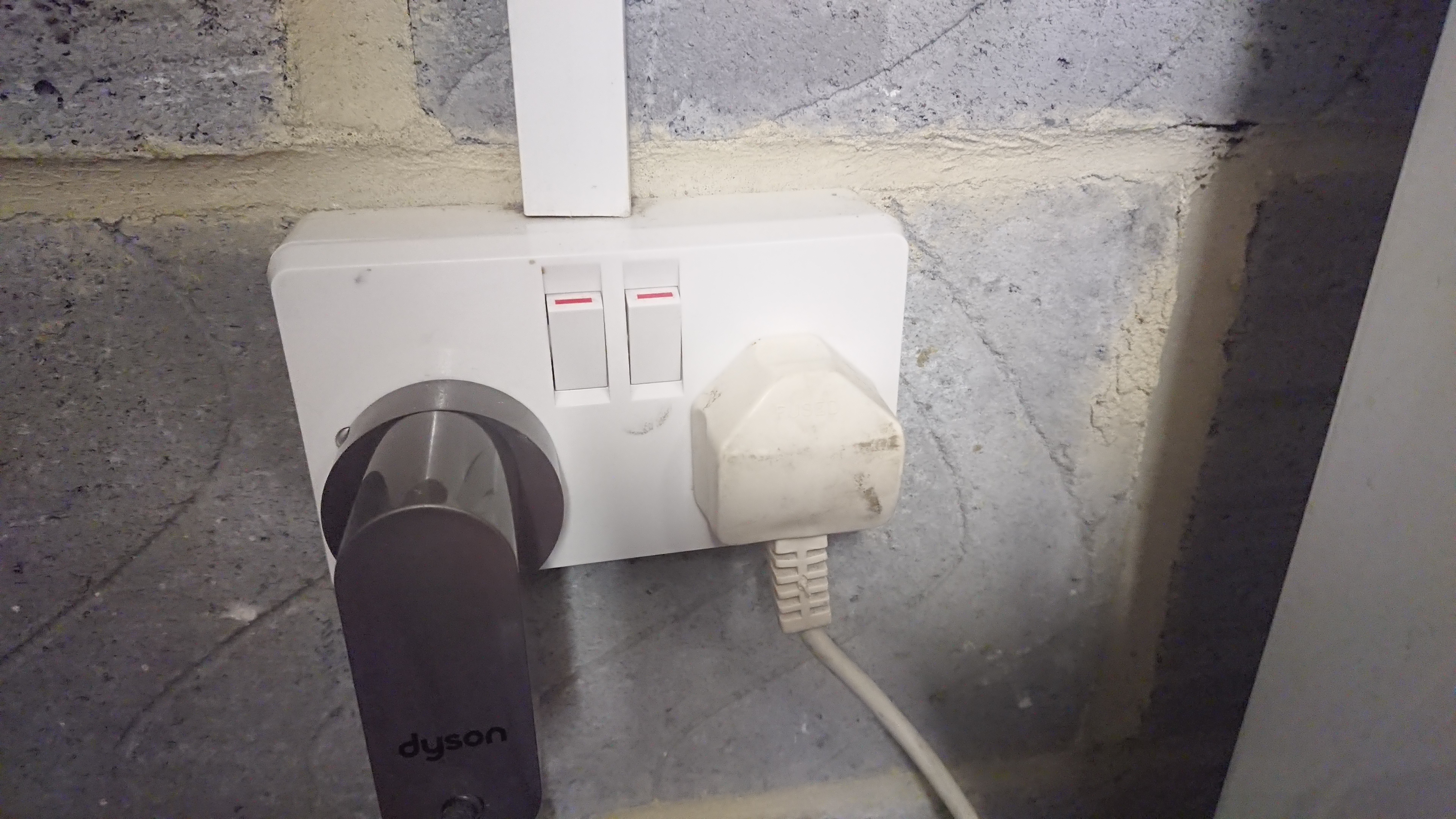

The tumbler was old anyway so I decided to replace it and the washer and freezer have been running fine for 2 days, I actually bought another 4 gang 10m reel cable with safetey cut out and plugged them into that.
Today the new tumbler arrived which I plugged into the extension where the washer and freezer are plugged in and it's started to cut out again, I've now tried the new tumbler in the new extension by itself and it's cutting out.
Any idea what's going on? Thanks

Just do as you suggested. Fridge on one socket and the other 2 on the other socket
I would pair the F/F with the washer and put the dryer on the other socket. The starting current of the fridge is high (maybe 10A) but the running current is probably less than an amp. That way, nothing will get significantly overloaded if the washer and dryer are used at once, proivded the installation is sound. The dryer has a continuous heavy load all the time it is running, the washer only when heating.
But yes, more sockets needed. Many extension leads sold in the high street have poor quality contacts that soon overheat and burn out with heavy loads. The contacts in decent wall sockets tend to be better made, so it's safer to plug heavy loads directly into the wall socket regardless of any overload situation.

Thanks, are you saying it would be ok to run the washer and fridge freezer at the same time on an extension? My plan in the short term was to run the FF in the wall socket (so it's permanently on) and the tumbler and washer one at a time on a short extension.
We use the washer daily so I don't want to be unplugging the FF every day whilst the washer is on.
I know the answer is more sockets but still not sure of the right combo of what to run where in the meantime now and what extension to get, I though a surge protection one would be good but someone sad that was a waste of money.
EDIT actually the tumbler won't reach the wall socket anyway, only the fridge does unless I have a major reshuffle
As has been previously mentioned, your socket may be damaged, cables overheated etc, you really need to get it checked asap. In the meantime FF and washer in one, tumbler in the other. Wiring safety check and extra sockets needed asap
