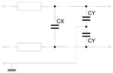

There will be EMI filters on those power supplies (see below)
The act of plugging them in (even without switching on) connects a capacitor between N and E (amongst other things).
If you aleady have leakage on that ring, the surge due to connecting the uncharged filter capacitor might just be responsible, but it's likely there is something else amiss.

When I unplug everything on the ring and then plug in one of the laptop power supplies it can still trip the RCD. It's not 100% repeatable though. Sometimes we can go weeks without tripping then it will happen every time we plug/unplug a supply. I think littlespark is correct and it's a cumulative earth leakage.
I agree. If you could beg/borrow a sensitive clamp leakage detector, you might find what is contributing to 'cumulative'.
