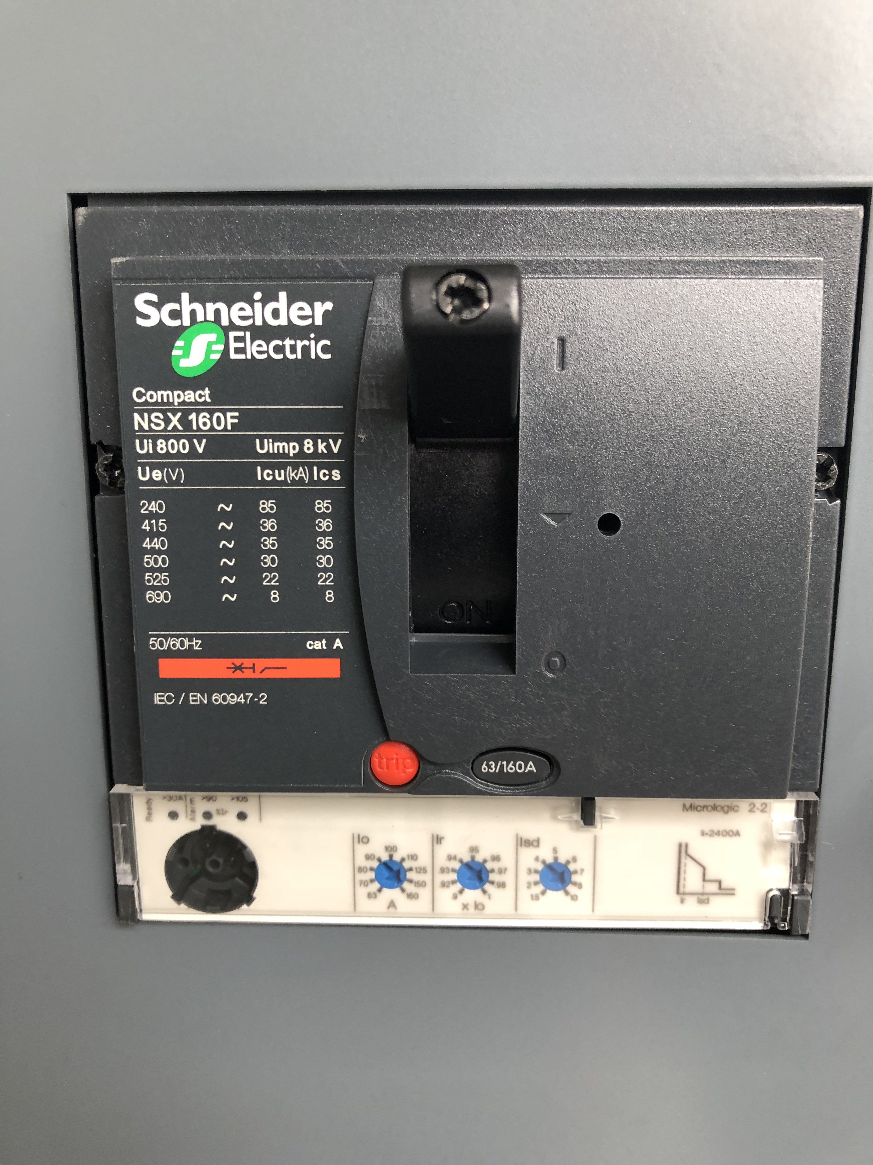

I know how they work never come across this type of breaker before and not had much to do with earth leakage relays thanks

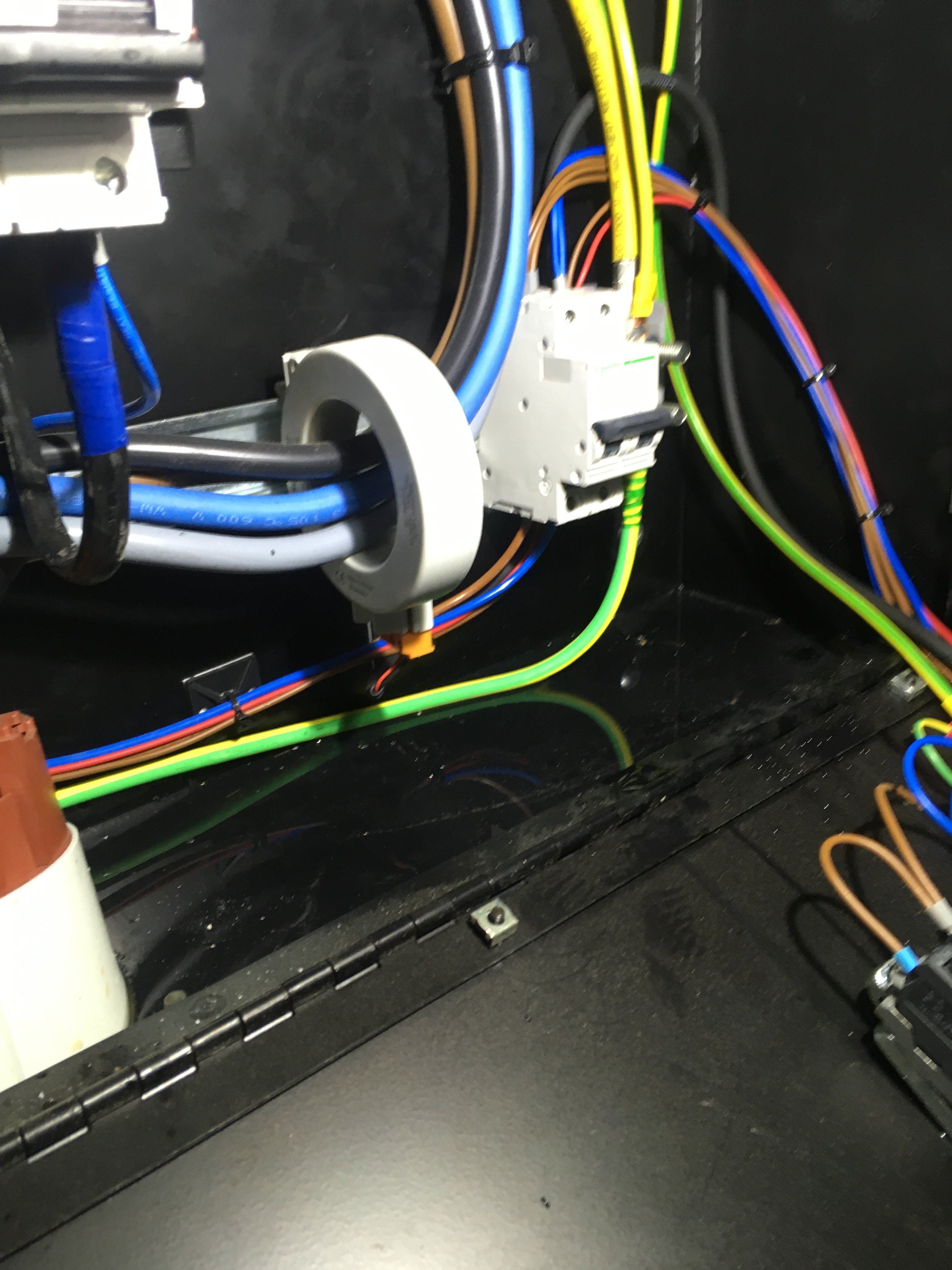

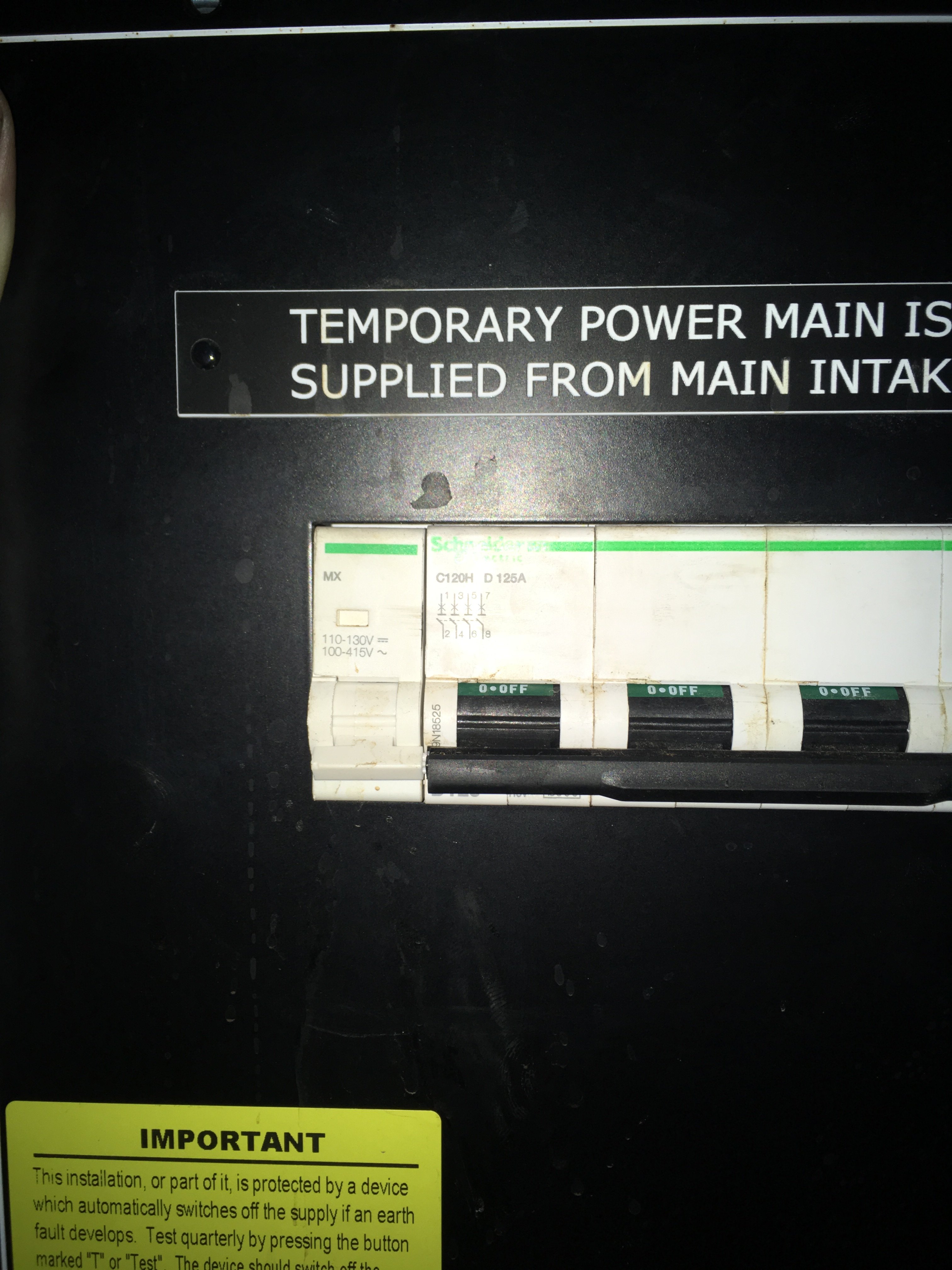

If that earth leakage relay trips the mccb then yes earth leakage protection has been added to it.
The earth leakage relay would connect to a shunt trip or undervoltage release fitted inside the mccb.
The sensing for the earth leakage relay is done by a type of current transformer which surround all live conductors and this measures the earth leakage.
The below pictures show the current transformer around all live conductors (the white ring) and the shunt trip on the side of an mcb, this particular unit is a 125A TPN socket outlet.
The bottom of the enclosure is full of water as the pictures were taken to record flood damage.

Thanks for that so say I put it on test report I’d put 60947-2 160A but would you put anything else if earth leakage was added eg

Just curious came across it the other day and never had anything to do with earth leakage relays before like I came to this and looked at test report and was unsure if you put over current for this distribution circuit obviously 60947-2 160A but added leakage if you put any associated RCD
