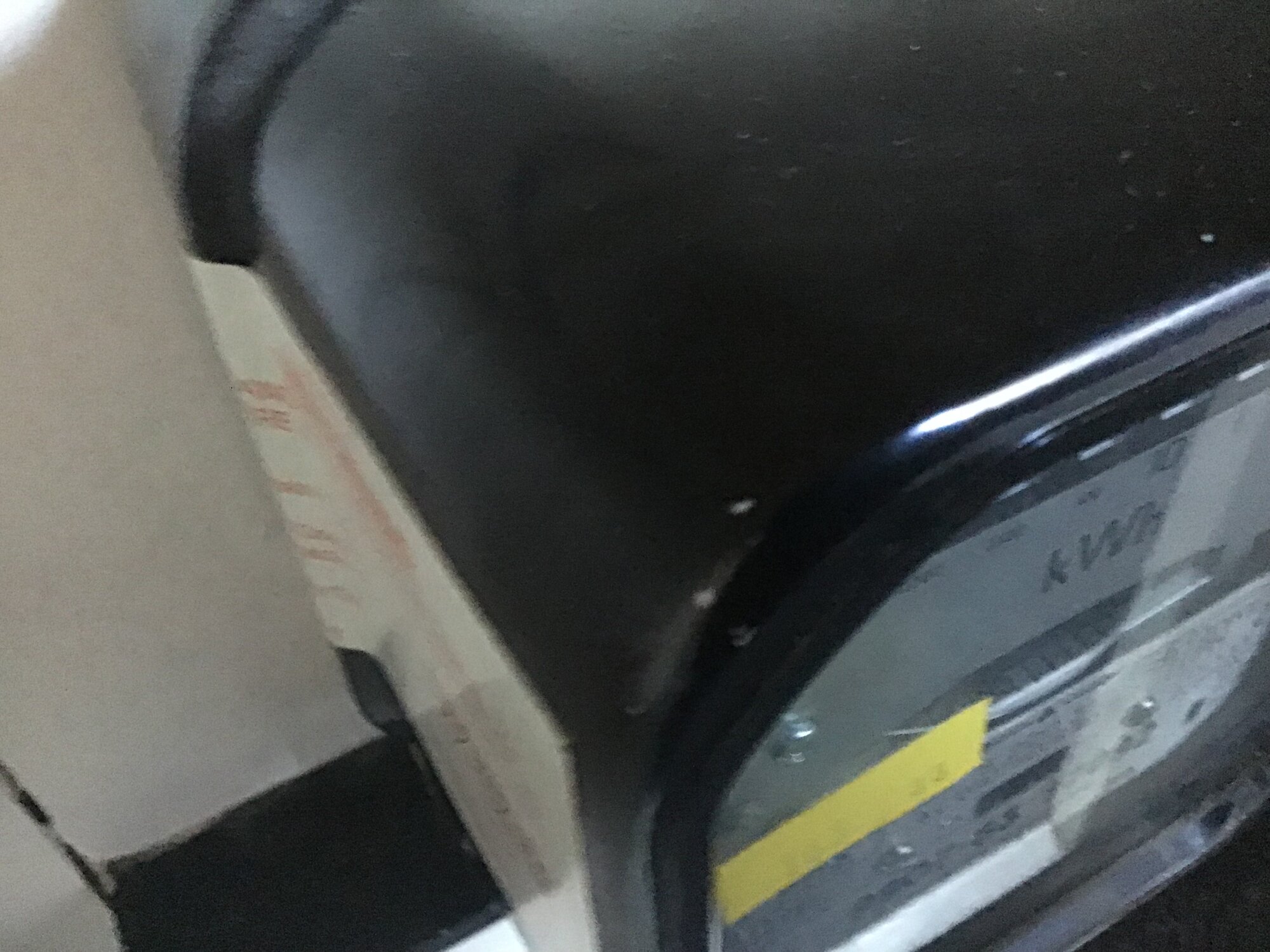

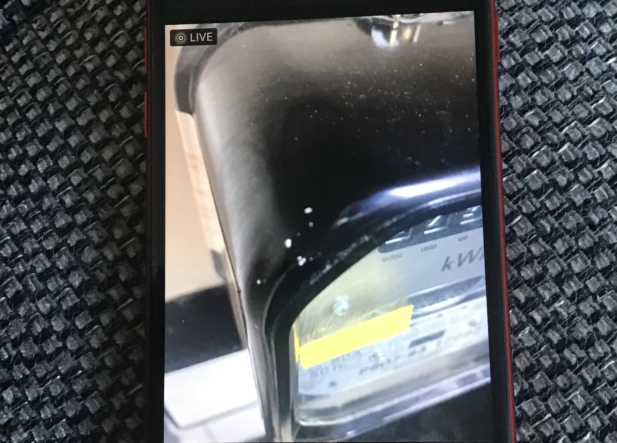

Unfortunately the photographs I have from my landlord cut off the meter, they only show the corner of the meter at the edge of them so I don’t have a photograph of the face of the meter.

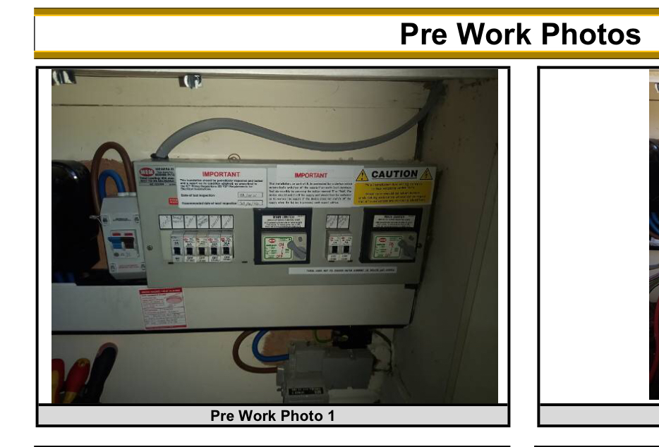

First picture is before isolator was fitted, second one is after but before consumer unit and third is when all work is completed.
The readings I posted are correct and I raised that the meter reading has gone backwards with the power company but they are saying no it has gone forward by 40,000.
I do wonder if perhaps a number has moved when the meter was off the wall as the if the first digit was still 7 then a reading of 77296 would have made sense. I just couldn’t explain how it could have happened though so the power company closed the investigation having viewed these images but without inspecting the meter.

The contractor who installed the isolator quite possibly will have pictures of before and after work, ideally you need these. The meter seals appear to be intact so this is evidence pointing towards you have tried to tamper with the meter.

looks like maybe the 1st digit. 7 changed alone to a 1. . then a sensible readoing between the 2 .allowing for actual usage.
The position of the Red sticker (for smoke detector?) on the trunking under the consumer unit and meter in the first photo is under the corner of the meter and on the second photo under the new isolator with the meter moved to the left.
The meter has most definitely been moved by whoever fitted the new isolator so will have been lifted off the wall and most likely laid on the floor. There will also be evidence of old screw holes for the meter fixings in the back board showing it's previous location.
This may have been what's disturbed the reading and together with evidence of previous energy usage should be enough to cast doubt on the current reading.
