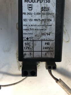

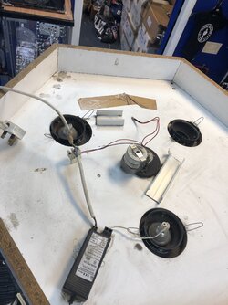

Have recently purchased a glass display stand in which the centre shelfs rotate. There are also 3 bulbs at the top. The display stand wasn't in the best condition and some wiring was missing and overall wasn't working. I'm hoping for some help and advice to fix this. I've attached some images to help. The motor doesn't work at all and the bulbs aren't wired properly in the first place to see if they're working.
More pics might be helpful.

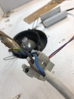

It looks like you have a plug, connected to a choc block. The motor is wired to the this, along with the transformer for the 12V lights.
What else is connected to the motor? It looks like a resistor?
Do you have anything to test what voltage you have and where?

Sounds great! How exactly would I go about powering the LEDs and the replacement motor?

Yes a resistor is connected. Any specific pictures that might be helpful? I do not have anything to test voltage.
I see a resistor but there also seems to be a capacitor at the terminal block, possibly in series with the motor although it is a 220V motor (many aren't). If that is the case and the motor doesn't work, either the motor itself or the capacitor could be faulty. Clear pics of the motor label, wiring and capacitor markings would be helpful.
None of this wiring or the motor should be exposed in normal use, and the motor might be supposed to be earthed. It is a bodge at the moment.
