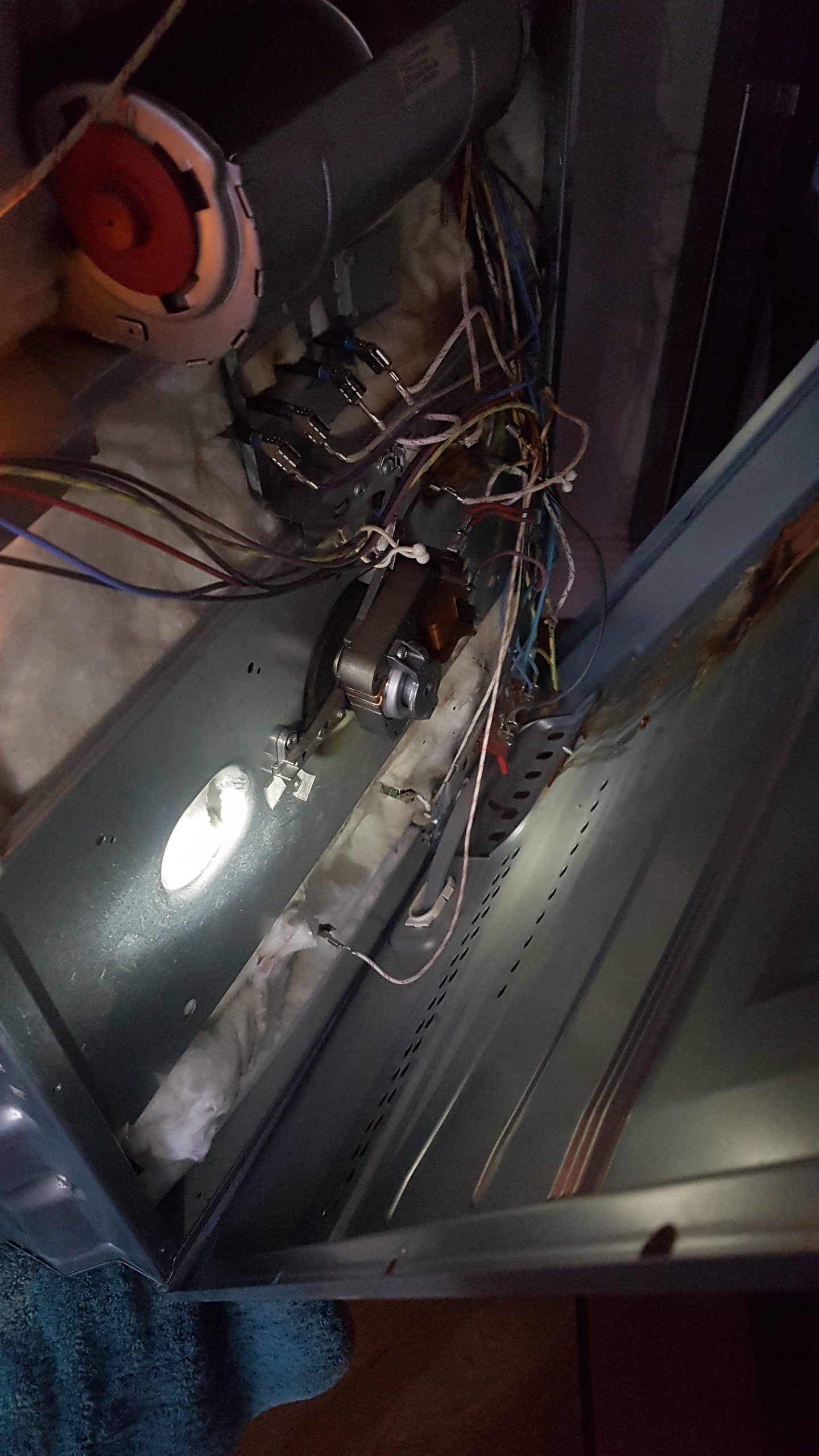

i have a neff oven that has been working fine for 3 years. top oven all works fine.
bottom oven I can choose from fan grill etc with the dial but as soon as I change temp from 0 within a few seconds it trips the rcd.
I bought a new bottom element and still same issue. don' think there is anything wrong with old one as multimeter shows continuity.
took thing apart and even swapped thermo from top oven with bottom and still trips so must be a bottom wiring issue?
there are 4 wires coming from the bottom thermostat dial. process of elimination I removed each wire and flicked power back on. it only seemed to trip when the red and white lead was connected - I followed this lead and it goes to where the bottom element goes into a small unit which I'm not sure what it is. on the image it is near the top with the red and white lead going into it. I put multi meter on this unit and it seems to have continuity.

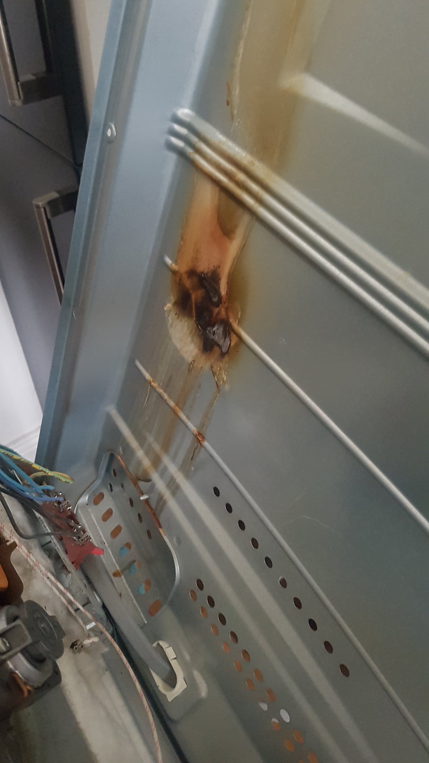

I did notice behind this area above, the back plate is burnt / marked
all cables looked attached properly and none were frayed but some look black from the above
just to add I done all the tests without the bottom element attached. as it was tripping with or without it. assume if it was the element and I removed it, it shouldn't trip?
please see images attached if they help

the burn mark on the rear cover plate appears to line up with the scorched wires circled in the pic.that;s where I'd be investigating.

that burn mark is apparently fumes over time from the bottom oven
thermostat wire goes into thermal cut out. other lead from thermal cut out has another 2 spade connectors - 1 goes into element which I've removed and other goes right down to bottom of oven where it is insulated. no idea what this is!
when I remove this 3 spade connector from thermal cut out It doesn't trip the rcd.
Hi - the thermal cut out will be in series with the oven wiring. Disconnecting it means the oven won't run (hopefully) and so it's not a surprise it's also stopped tripping the RCD. I am concerned for your safety with those exposed live components and an unknown fault present. My advice is to please stop experimenting and get some help :)

IR test on the element is the first thing to do.
The other prong is probably the neutral to the element? Cant see from the pics, but as others have said please stop playing now somethings gonna go bang

it was lower bottom element tripping rcd.
replaced and is fine but one question
when I went to replace the element that goes around the fan there are 3 wires coming from the back. the photo I took only had 2 wires connected to the element so this must have popped of when removing as it's quite short and can only reach the hole where the element goes. I can't workout where it should go on the element though or does matter? the other end connects to the grill element situated at top of lower oven. this element has 4 connections and is coming off the last one.
in the element around the fan I have a wire attached on prong 2 and wire on 4. this is what I took a photo of.
does it matter if this other wire goes on 1 or 3?
