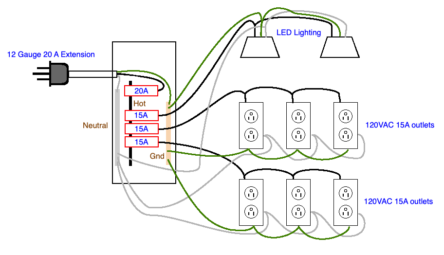

thanks, i had a similar suggestion elsewhere. just got this drawing through as well. what do you think.

Just got this drawing through as well. what do you think.
Specifically for America, and arguably not correct practice there either.
I do not know what you have against daisy-chaining socket-outlets. It is the normal way to connect them.
What is the source of power that is going to feed this room? Will it plug into the wall with a Schuko plug or something bigger? What appliances are going to be used inside - is there an electric heater?
You seem to have a USA background in terms of the example currents/voltages/wire-by-gauge references.
UK and EU building supplies will be 230V nominal, i.e. using a blue "commando" connector such as this for the inlet:
However, for building sites and similar it is common to have 110V (yellow version of that connector - not interchangeable) from a centre-tap transformer or generator so 55-0-55V for less risk of electric shock. Comparable with USA practice of 120-0-120V supplies for any 240V loads, fed with linked double-pole breakers.
For 110V applications you normally need double-pole breakers for that reason, as both live conductors can produce a high fault current to earth/ground.
In the UK 230V is usually single-pole over-current protection in the line/hot wire only, but for caravans, etc, you must have double-pole RCD for shock protection (so neutral/cold is simultaneously interrupted with L on a fault).
In the EU it is often double-pole over-current protection as they have historically not had the close-to-ground neutral the UK has had, nor have they always used polarised plugs & sockets (so L/N can be swapped by plug direction) so frequently appliances will have protection in both L & N.
TL;DR - you need to be sure of where your power will come from to get the right voltage to begin with!
We're in danger of overthinking this. I understand it to be a kind of mobile conference quiet-zone booth that can be positioned in an office, as he describes it as wooden and on castors.
As with any electrical installation, the design depends on what electrical equipment needs to be powered although some of it is fairly obvious, A few laptops, the video conference equipment, lighting, a fan or two and at a push, a Nespresso machine.
The total load is likely to be below 16A and it could plug into the office wall socket with a Schuko plug, aggregate earth-leakage permitting, This means the whole setup is basically a posh extension lead, which does not need a distribution board. If it is protected at source with a 16A MCB, there is no point putting any 16A MCBs within the unit. It is common practice to use 16A circuits for lighting in EU, so there may be no need to fuse anything down below 16A either.
The two caveats with supplying it from a Schuko plug are the lack of polarisation, requiring any switchgear that is used to be double-pole, and the functional leakage. If there is a full rack of VC equipment and/or an expectation of multiple desktop computers in use then the leakage might be quite a few milliamps. I don't know whether there are now regulations in Germany stipulating the maximum functional leakage that should be passed through one plug and socket outlet, as there are in the UK. If there are, and the leakage is likely to exceed the limit, then connection to the supply via an EN60309 plug would be needed. OTOH a self-contained VC unit, a TV, a sound bar and a few laptops would probably. be fine on a Schuko.
This reminds me I must brush up on current German regs, I am 30 years out of date.
Yes, re-reading the thread and it looks like an indoors display, so many of the concerns are less of an issue and it is, as you say, more of an extension block on steroids.
In that case it is probably powered off a 16A Schuko socket somewhere in EU, or a 13A socket if in the UK. It might still be an idea to use a 16A commando inlet and then have some extension cables made up for use different locations though, instead of a long trailing lead that might need a plug/socket adaptor to be used in addition.
As transportable and probably likely to flex a lot, I would also suggest it is wired in flexible cable such as H07RN-F (with ferrules on the ends!) to reduce the risk of cable faults from vibration induced movement cracking conductors. While it is not an area I normally deal with, I seem to remember that is in UK regs for caravans?
