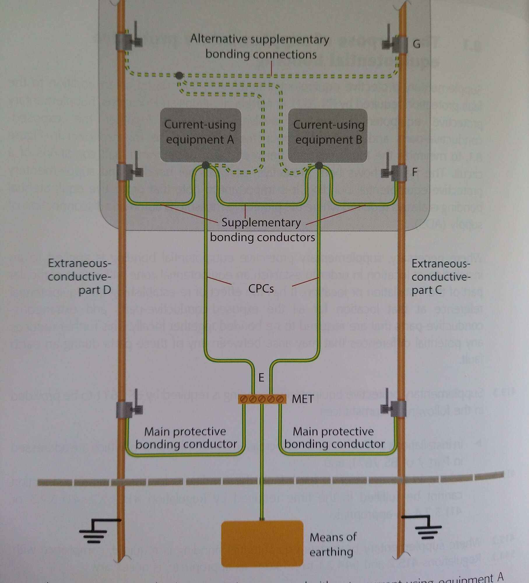

It's (theoretically) possible that by applying the calculations for minimum supplementary bonding csa that if it comes back in small enough (min 4mm) that your SWA armoured might be up to the job, in which case just extend the PME. Have a read of GN8.
There is no supplementary bonding requirement. This is mainly about mitigating the risks of a broken PEN conductor.
The minimum size for a bonding conductors with a PME supply is 10mm
see Reg 544.1.1 & table 54.8
I believe this is todo with high current under PEN fault conditions and the potential for diverted neutral currents
But are we discussing main bonding or supplementary??
Although you say currently you have an earth rod connected to the PME earth at the workshop, this earth rod could be counted as an extraneous conductive part, if you were to leave it this way with that earth there would need to be a minimum of a 10mm conductor connecting that earth rod to the PME MET
This is also the case for any other extraneous conductive part in either of the buildings, like water pipes etc
Sorry I don't understand how that would protect against a broken PEN conductor?
There is no bonding requirement. No water pipes or anything like that in the outbuildings.
That make TT easier then, H
Wouldn't it be main bonding
Exposed conductive parts yes, extraneous conductive parts no, unless you include the earth rod itself in that category.
In its current configuration, the earth rod is classed as an extraneous conductive part as currently the PME earth is in use at the workshop.
However you want to isolate the PME earth and change to TT, in that case the earth rod will become the earth electrode for the workshop TT system.
