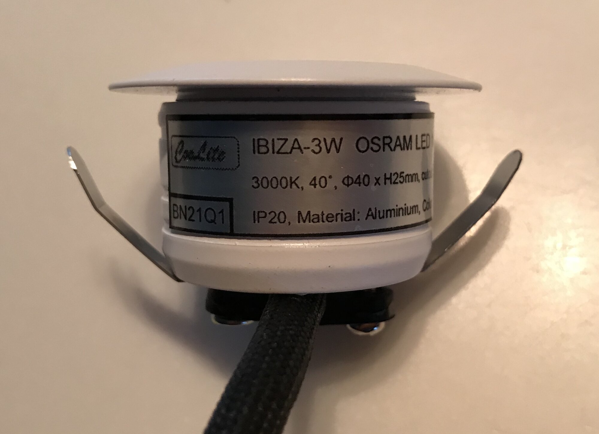

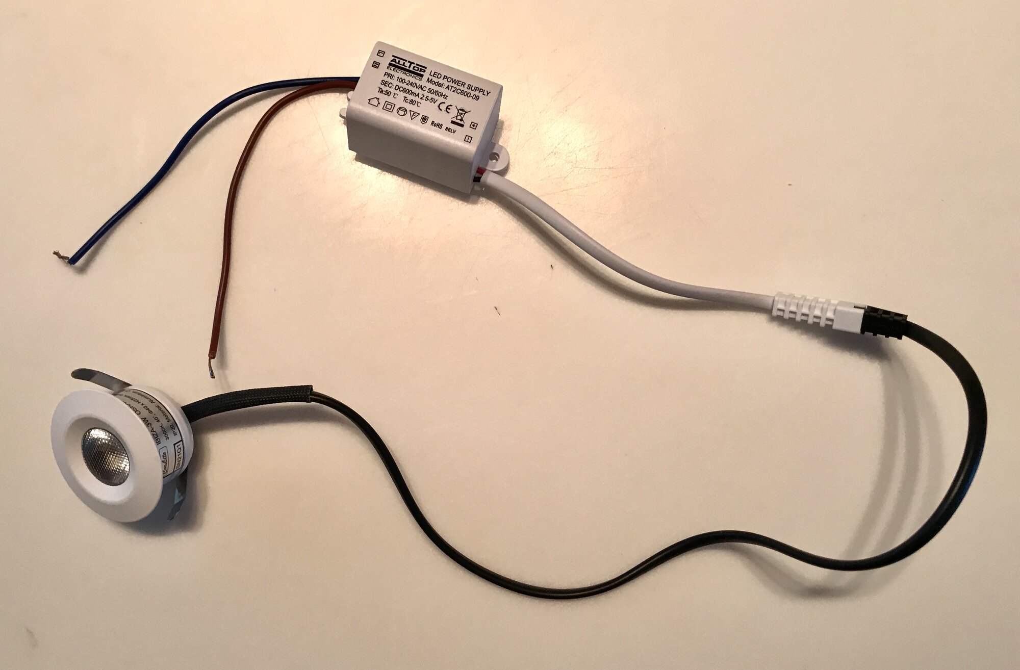

The new spots are 3W LED's each with their own little transformer connected, and naturally they both have 2 wires to connect them to the mains, a Brown (L) and a Blue (N)

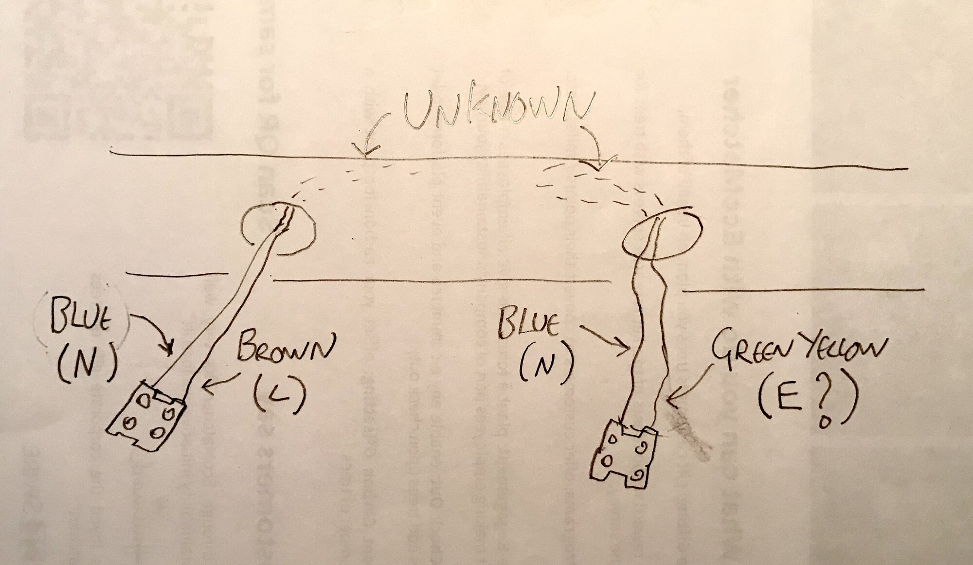

Thanks for the reply, Images attached (I knew I should have taken a shot of the installation)
As for the wire type, there is only insulation on each, (1.5mm) (including the 'earth' G/Y), there's no cable jacket (normal in HK) so I can't see how the wires are grouped together inside the wall.
Noted re the voltage pen, I will say that it gives a very definitive signal when the wall switch is on and zero signal when it's off.
If I used a two prong voltage tester (or M.meter), what would I be looking for exactly?

It seems I did take 1 photo after all, it doesn't really tell us much more other than the wires run inside tiled plywood.
The other hole (not pictured) is the same set up, except that the L is replaced by a G/Y insulated wire.

I think we need someone fluent in hong kong standards before further advise.
That cable looks big just for lighting.... and lack of sheath, or conduit is unusual.
I still think there's cables missing. minimum, you would need a live, neutral and earth at each hole.
You might need an inspection camera to look inside.
Is there no access to this void at all? screwed hatch, plasterboard on other side of wall that you could make a hatch?

Many thanks for the diagnosis.
Hmmm welcome to HK, the standards here are the standards of the UK from 25 years ago that have largely gone unupdated in that time.
Added to that you have almost zero rule enforcement and a constant desire to save time and money and an ‘it’s somebody else’s problem’ attitude.
So yeah, a bit Wild West.
In HK all residential buildings are concrete, no wall cavities (generally) and no insulation (ever). So inspection hatches largely don’t exist and the wall

See attached image from my flat. When some remodelling was done, the wiring for the lights was extended and new wiring added for another AC unit. Sheathing without conduit or conduit without sheathing...... and no earth for the lights.
Conduit would have been used inside all the concrete walls, in this the bathroom lights building (as it is in all of them) but when someone remodelled their basic bathroom, the contractor, seeking to cut as many corners as possible would have just built a plywood box around the wires to act as a housing for the lights. In his mind, if it looks ok, that’s all that matters - the plywood box is the conduit for the wires - welcome to China.
This is another room in a different building that wants some work doing and is absolutely typical. Wires in conduit until they exit the wall, and then....anything goes. Wires ‘terminated’ with a scrap of insulation tape and left in a tangled heap....
So back to the job at hand..... I guess I can fish around inside the void with some hook and see if I can pull out any more wires...., but even then, even if I find any, there is nowhere to attach any earth to the light housing - I could improvise that. The lights have L and N only....
Is there anything else I can do, a photo inside the switch for these lights that will help me get an answer from afar?
