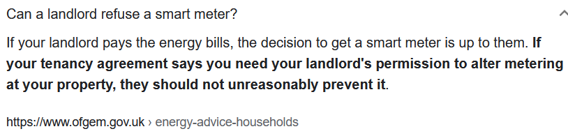

No need for additional meters, the Tenant has the right to have a "Smart" Meter installed.
The meter does not belong to the Landlord.
The landlord owns the property. The property is private. If he/she doesn't want a smart meter it's up to them. That quote from Ofgem doesn't say otherwise. The word is "unreasonably". The electricity company doesn't get to define that. Nor does the government. As far as I'm aware.
Anyway, that said, are you aware of a device such as the one I described?
The landlord has absolutely no authority to prevent a smart meter from being installed
Like I said. It depends on what is deemed "unreasonable" and who deems it so.
I can't envisage the government breaking into a private property to force a smart meter on the owner on behalf of the electricity companies. Not yet at least.
Besides, it's never a good idea to pick a fight with the person who controls your rent payment or your tenancy. Not if you're happy where you are. About anything really and least of all a smart meter.
