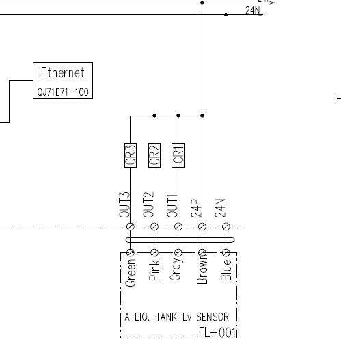

I have been trying to solve this problem for months now. I work as an Electrical Engineer in a tunnel project, we will use TBM machine to drill the underground station.

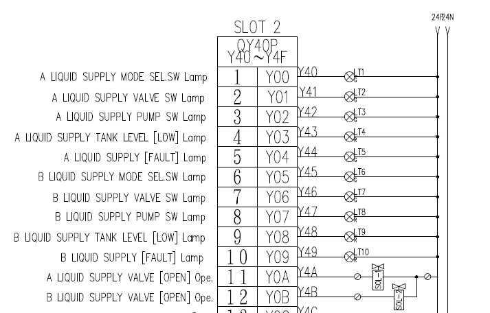

We just realized that for the new TBM machine that we bought, we actually have 2 tanks of grout component, called component A. The problem is, we are using the panel for old TBM machine where the component A tank only have one.
So, in order to provide additional control for the second tank to the existing control for the first tank, I am planning to modify a little bit of the control circuit where, from the level sensor in the tank, it will send signal to the PLC in the panel. This PLC will send command for the valve to open, and hence will make the pump runs.
We do not intend to modify any coding in PLC since it was done by a subcontractor. What we can do is only mechanical modifications, where my boss gave an idea to use a simple relay. He asked me to crack down on how to implement it, maybe using 4 poles relay, but until now I still can't figure it out.
I was trying to implement the simple basic start and stop pushbutton circuit, where I try to manipulate the start and stop pushbutton by changing it to high and low signal from the level sensor, but the problem on how to connect them to PLC still cannot be solved, since we need to integrate two signals from two level sensors into one slot of PLC, and from one slot of output PLC to command either two valves to open.

You are correct. That is why we dont really want to ask the subcon to make changes (that would be the last resort if nothing else can be done) because they would charge a lot more for it.
The control of the tanks is connected from tunnel to surface. So on surface we have one grout plant that will receive signal from tank in tunnel whether the grout needed to refill or not. The existing control for refilling the tank is only for 1st tank only while the 2nd tank is the new addition added by the TBM supplier.
There must be a reason for the new TBM to have two tanks, so the programming would reflect how they are supposed to be used. E.g. to allow a minimum agitation time, or a maximum open life of the grout component, in which case it would draw from whichever tank has material in the correct state rather than both at once. Or as DMX says, it might be intended to draw from both for maximum flow rate, and keep them at the same level, and there are only two tanks because they are easier to make than one big one. We don't know any of this so we can't suggest a work-around. Nor do we know what the PLC does under error conditions, e.g. what happens when the 'low' level is continuously detected. What should it do if one tank is high when the other is low? Is that an error condition in its own right?
So this seems to be beyond the scope of simply switching the PLC's inputs and outputs from one tank's sensors and valves to the other. If you are completely familiar with the process and you know that it is possible to just choose one tank manually, then you might be able to fool it by switching CR1-3 and X37-38 between tanks, but beware creating error conditions if for example the PLC detects an impossible transitional state during the changeover, e.g for a moment both high and low levels are detected.
