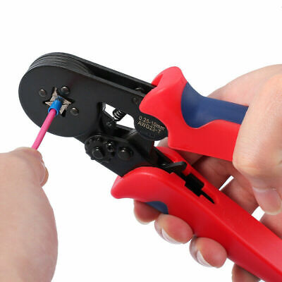

And as a side question ferrules how many people use them all the time on stranded cables or only up to a certain size and whats the best crimping tool for ferrules.

..and ferrules are for flexible rather than stranded.

Also already mentioned is ferrules are used for fine stranded flexible cables (such as tri-rated for control panels, or H07RN-F rubber outdoor) and not usually for the 7-stranded cables used for "fixed wiring". If you only use up to 10mm cables (probably the majority of cases) then I would go for the self-adjusting crimp as they save you having to get it in the right slot (and leaver it out if it is stuck in one too small). This is a high quality example:
But you get adequate ones off eBay for 1/10 the cost (probably less than 1/10 the operating life as well, but for light use adequate). Something like:
Again for light use one of the kits with crimp tool and a box of various ferrules is handy.
