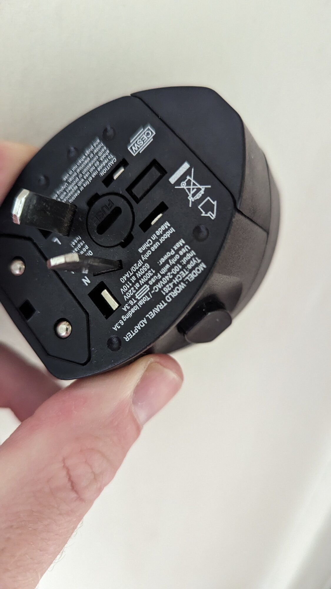

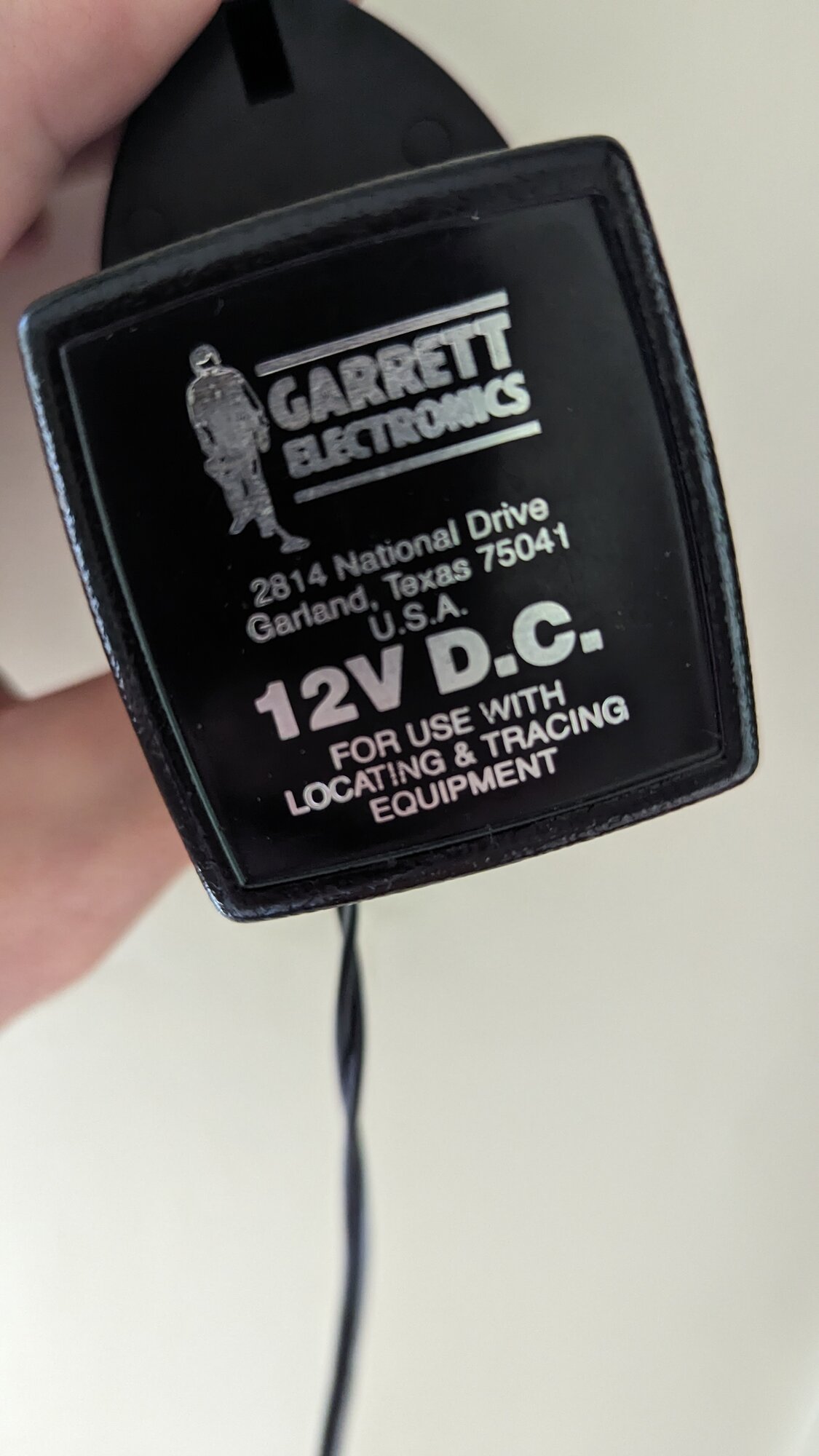

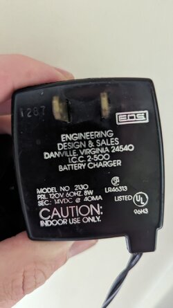

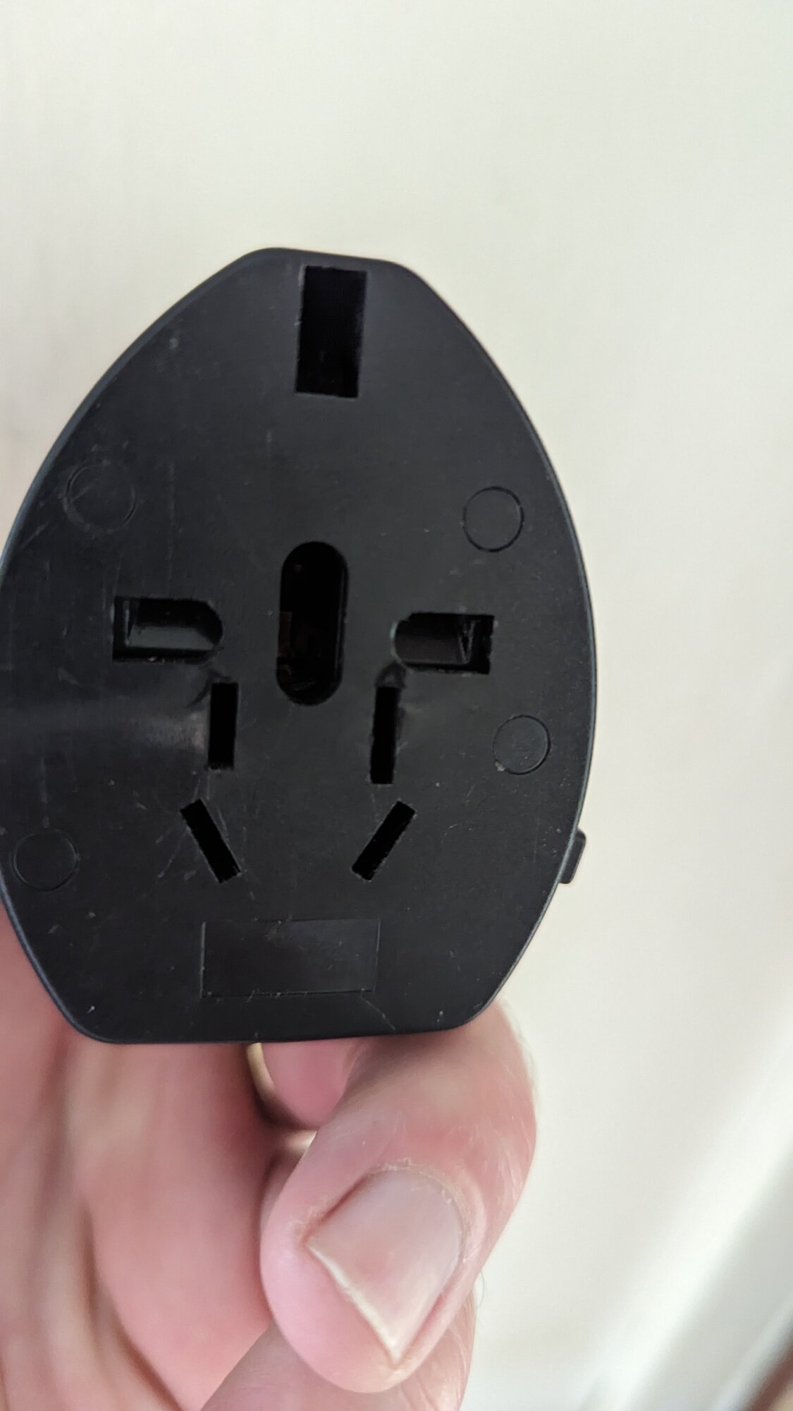

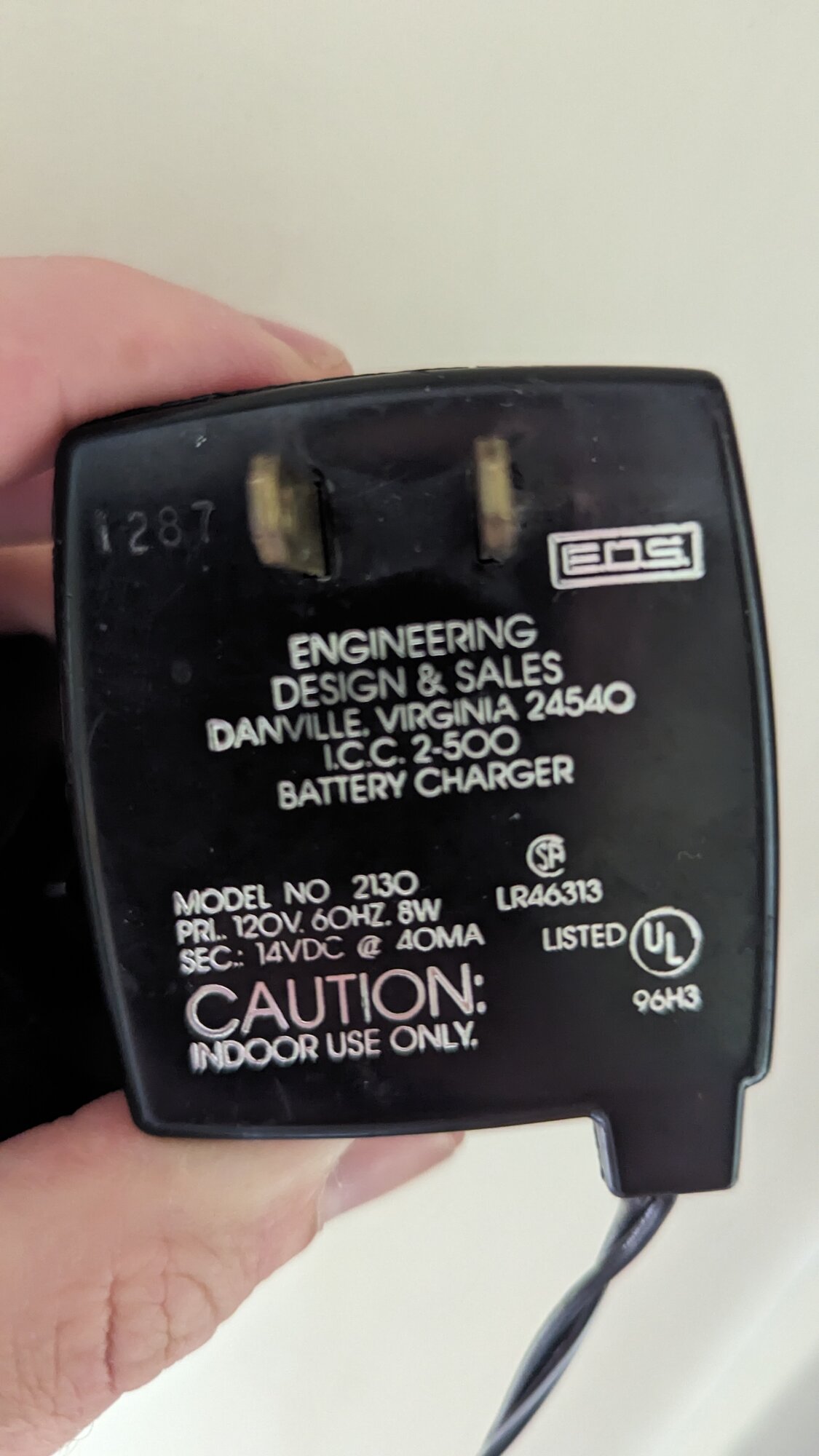

I recently purchased an old detector with charger from the US.
Plugged it in with converting plug into Australian GPO and charger, it started heating up and smoking. Please see attached pictures. Both the US and charging plug and converter had gotten extremely hot.
Does the current need converting somehow for this to work?
Have a destroyed my purchase?
Could the plug be replaced with the Australian equivalent?

The converting plug converts the pin type only.
Whatever voltage you put in, 240v in Australia? , you will get out the other side.
The U.S charger only works on 120v, but has just had 240v? put in it, hence the smoke.
That'll be goodbye to that 120v to 12v DC charger.
If the 12v lead out the charger to the detector was also smoking, you've probably damaged the detector.
Hopefully not.
Assuming the 12v DC charger plugs into the detector, what you need is a 240v? to 12v DC charger of a similar seconday rating, 14vDC @ 40ma, with AUS 240v pins and 12v DC plug to match the detector.
Bin the converter and 120v charger
