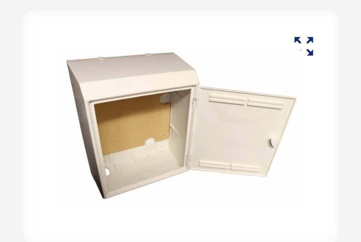

For example if they say use 2 x 16mm swa to each one this mean I need second electrical box next to the meter with small fusebox to glan the 2x Swa .
I'm confused
That would be the easiest way, enclosed in some sort of weatherproof structure which the builders will probably be happy to make. Then run appropriate circuit to each cabin.

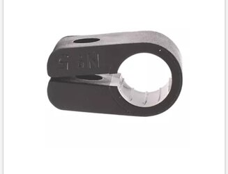

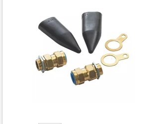

16mm swa 3core 30 metre
Cleat

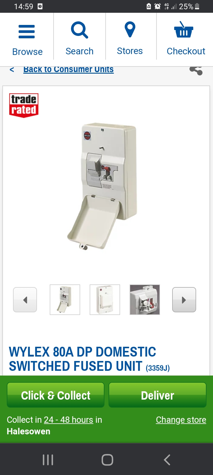

60amp metal kmf switch
Glans

I see. As @James mentioned earlier, such cabins are often supplied via an external connector, in which case supply directly from switchfuse may far exceed its rating.
