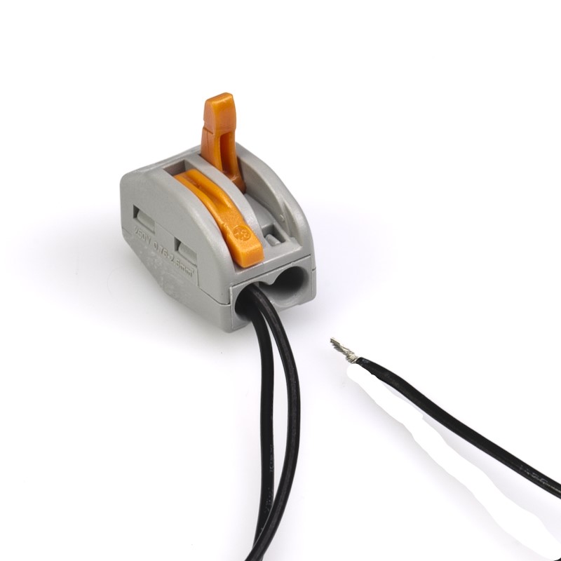

Hi, hopefully you can help.
I am installing 5 external floodlights in the garden. The units have a 1.5 mtr cable with a 13amp plug. I am fitting these around some new decking and the cables are to short. So i want to join them all up using 121 cable connectors to extend the cable a cpl of mtr's. to a single junction box and have one cable coming out of the box. and run them from a single cable with a 13amp plug into an external socket. Now i cant seem to find something that will join all these wires into a single wire for the plug.
Can i put 4 lives twisted together into a single block and the 4 neutral and then 4 earths, then just put the plug wires into the block. Do i just need a bigger size block to fit all 4 cables into one hole?.
There does not seem to be a block where the live wires etc are all joined.
Attached a layout and explanation

Each of the 5-way Wago blocks takes 5 conductors and they are all connected together by the terminal. So one Wago for L, another for N, a 3rd for E, etc.
Wago also do an 8-way, but the push-in style (773 series) are not suitable for fine stranded wire as you might have for light flex, also they are a bit of a pain to get the wire back out if you made a mistake.

If you have 4 lights and 2 other cables (supply in, and out to rest of lights) you need 6-way, so daisy chain pairs of 5-way to get 8 usable ways per conductor.

So at junction box 1 you have 5 sets of 3-core cables, so you need 3 sets of 5-way terminals, one per core.
At junction box 2 you have 3 sets of 3-core cable, but as you bought a box of 5-way Wagos you again use 3 * 5-way there.
Simplez!
FFS! of course!.... I have been over thinking it, getting stressed and doubting myself....Thanks mate, that should do it.
