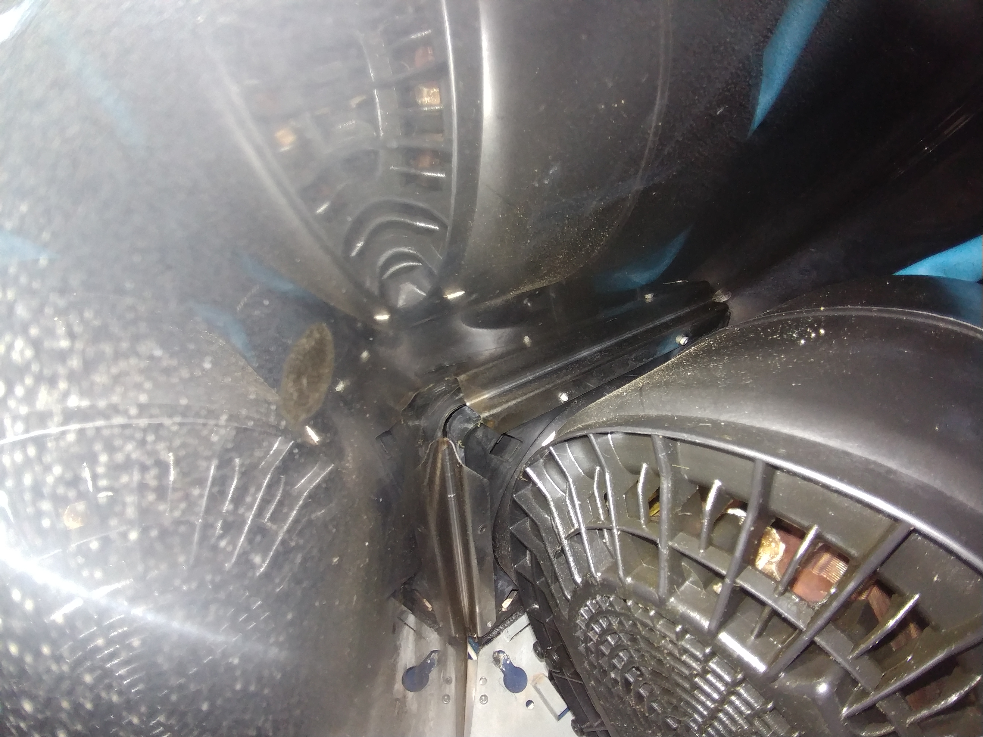

Hope i could get your help and advice please .
I have indesit HGM61X coocker hood and i believe the fuse is blown because of the blown bulb.
The power source connection or the fuse is normally behind the chimny part, and this is my problem.
I cant seem to see any screws to undo to remove the chimney cover to access the fuse on the socket or the control panel .
.........Please see attached photos.........
Please correct if i m wrong and would be most gtreaful if you could advise me on how to resolve this.
Many thanks

I have removed all screws i could see from the hood and still cant take it out .
I could not see any hidden screws behind and gray stuff . Please see morr pictures i attached here .
It would seem you have no charcoal filters over your motors, which is not a good idea for recirculated air fans such as that.
If you work with a multi tool you should be able to neatly remove coving and put it back after and with a good bit of redecoration no-one will ever know.
Yes nofiliter, but it just going to extract the air to outside , think no big deal ?
