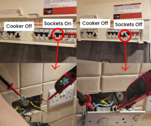

Hi there, wondering if anyone can give me some advice please.
In my kitchen I have a cooker switch with a plug socket which I believe is on a dedicated circuit. If I test it with a Voltage Tester it read all correct as it should. Now if I turn off the Mcb on the CU which is labeled "Cooker" it still shows a Voltage of 3.
On the CU there is another mcb which is labeled "Sockets" which is powering the washing, dishwasher, hob, and hood on a plate with 4 switches and 4 fuses altogether and also a separate switch with a fuse powering the fridge.
If I turn this off there is no Voltage to the Cooker Switch/Socket.
I want to know if this is normal or not please?
I have attached some photos if that helps at all.
Thank you in advance :)

That's probably capacitive coupling from the appliance gridswitch feed cable to the cooker cable, if the two run side-by-side for some distance. When a conductor is completely isolated, as would be the line core of the cooker cable when both the MCB and the isolator are switched off, it can take up any potential induced on it by fields from other cables. What exact voltage you read depends on the input resistance of the meter or tester. If that is very high (i.e. it does not load down the conductor under test) then you can get quite high readings, up to 100V or more in some cases, on supposedly disconnected wiring. That voltage collapses as soon as even the tiniest load is applied, because it is actually a very high-impedance current source, leading to the common term 'ghost voltage.'
What is the model of tester you are using there? It would be interesting to know the input resistance. Many testers have a deliberately low input resistance to avoid registering ghost voltages but some do not, nor do multimeters which deliberately have as high an input resistance as possible.
TIS 851 Voltage & Continuity Tester - Self Proving
Here's the link for you if that helps....
The accuracy of that test instrument at such a low voltage is going to be awful. It says 3 volts but it might only be 1.5 or 2 volts. I can't imagine why they thought it was a good idea to even display or register voltages that low. Personally I would consider anything below 12 volts as dead unless the input resistance of the instument you're using is less than 1 M ohms.
